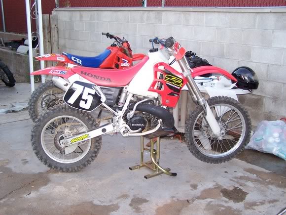

Heres my old 1987 from 5-6 years ago.![Ride :ride: :ride:](https://www.dirtbikeaddicts.com/static/images/smilies/ride.gif)

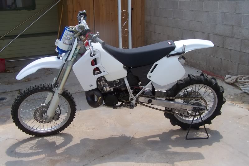

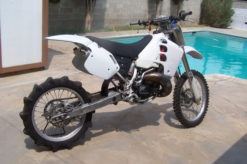

I pulled the motor and parted the rest then slapped it in a 2000 rolling chassis I picked up cheap...:tee:
A few days of wrenching later...
rive:

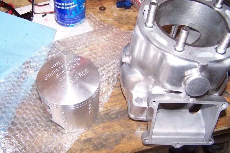

I ran her like that for a couple of years and then one day a buddy of mine hit some hard times and I aquired his $1800 port job top end for $400, it is ported for dunes/hillclimbing....![Banana :banana: :banana:](https://www.dirtbikeaddicts.com/static/images/smilies/banana.gif)

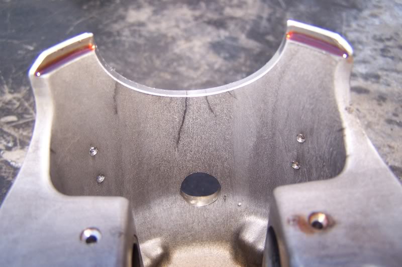

She was running perfect just a little down on compression, I pulled the head and found this
After more wrenching I found the bottom end was toast, the crank had play and a dog snapped off in the tranny and pretty much ruined everything, it was amazing it still ran awsome!

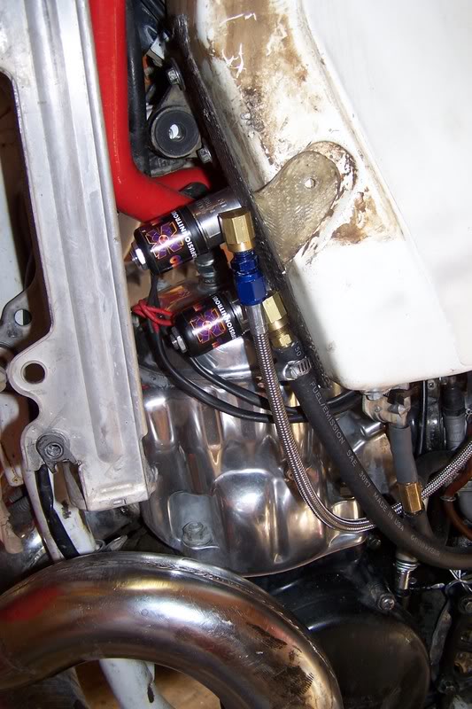

Solenoids...

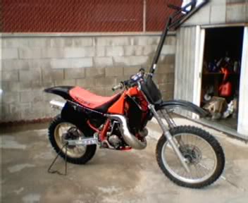

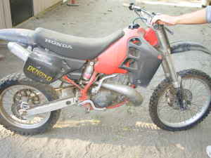

![Picture14.jpg](/content/proxy.php?image=http%3A%2F%2Fimg.photobucket.com%2Falbums%2Fv681%2Fbritincali%2FPicture14.jpg&hash=0cc075645ad5b9856ec1c2dc6218f52c)

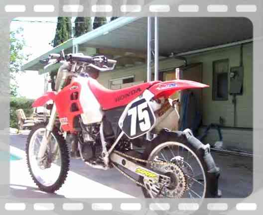

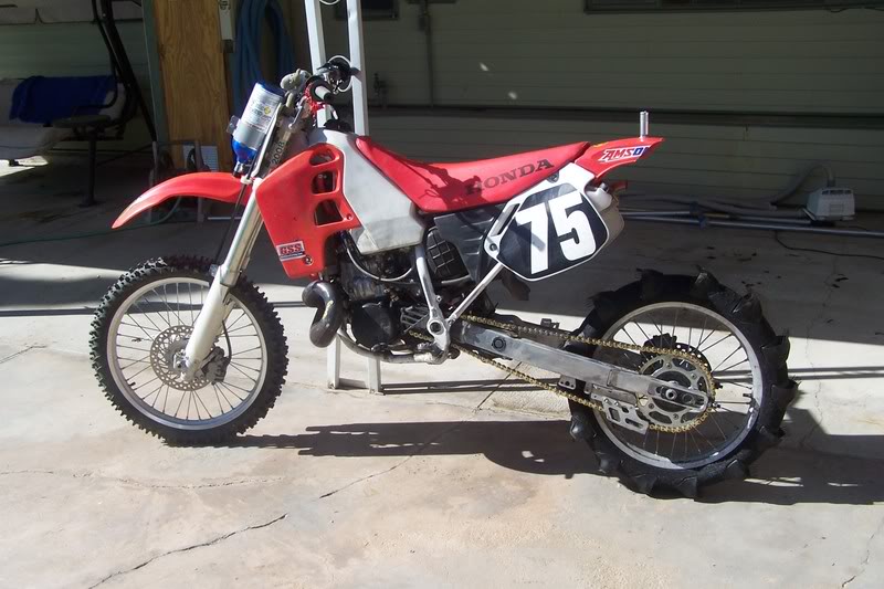

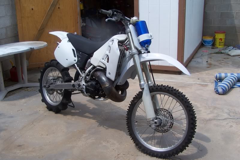

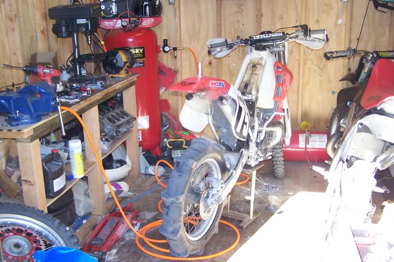

![Biggrin :D :D](https://www.dirtbikeaddicts.com/static/images/smilies/biggrin.gif)
![100_0003.jpg](/content/proxy.php?image=http%3A%2F%2Fimg.photobucket.com%2Falbums%2Fv681%2Fbritincali%2F100_0003.jpg&hash=4885aa34034de1b0699482981586a871)

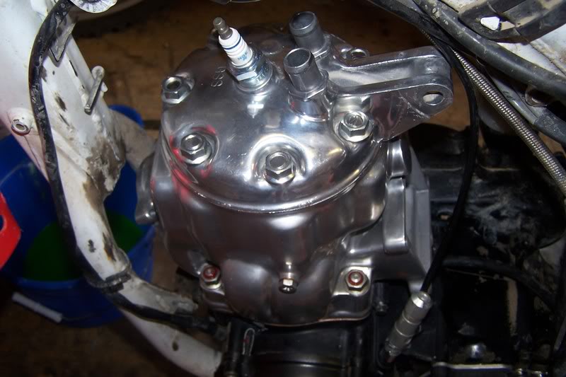

![100_2293.jpg](/content/proxy.php?image=http%3A%2F%2Fimg.photobucket.com%2Falbums%2Fv681%2Fbritincali%2F100_2293.jpg&hash=4a7035ae8f8a086ba5b76cf7be134962)

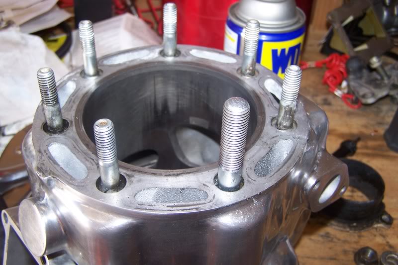

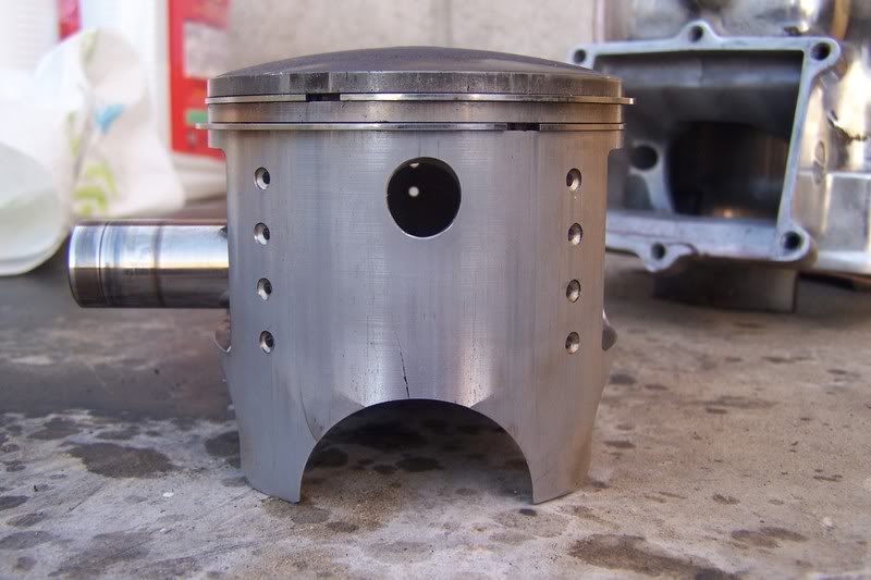

![Frown :( :(](https://www.dirtbikeaddicts.com/static/images/smilies/frown.gif)
![100_2315.jpg](/content/proxy.php?image=http%3A%2F%2Fimg.photobucket.com%2Falbums%2Fv681%2Fbritincali%2F100_2315.jpg&hash=c4fc487f142e3ae8414ed18b7e2f9ba3)

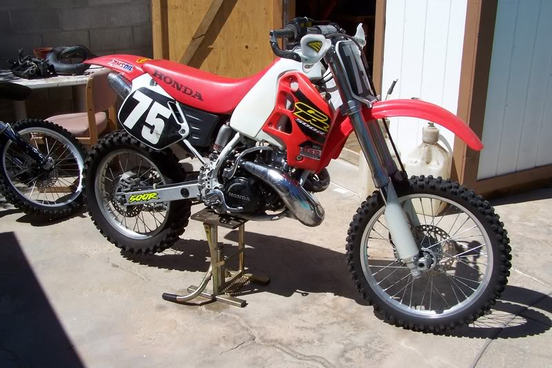

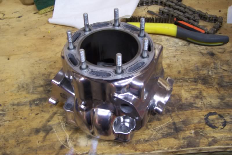

Heres the 89 bottom end with the ported/polished top end....
![000_0033.jpg](/content/proxy.php?image=http%3A%2F%2Fimg.photobucket.com%2Falbums%2Fv681%2Fbritincali%2F000_0033.jpg&hash=8ca5f93b627c87fce71e1881d3a4d1ab)

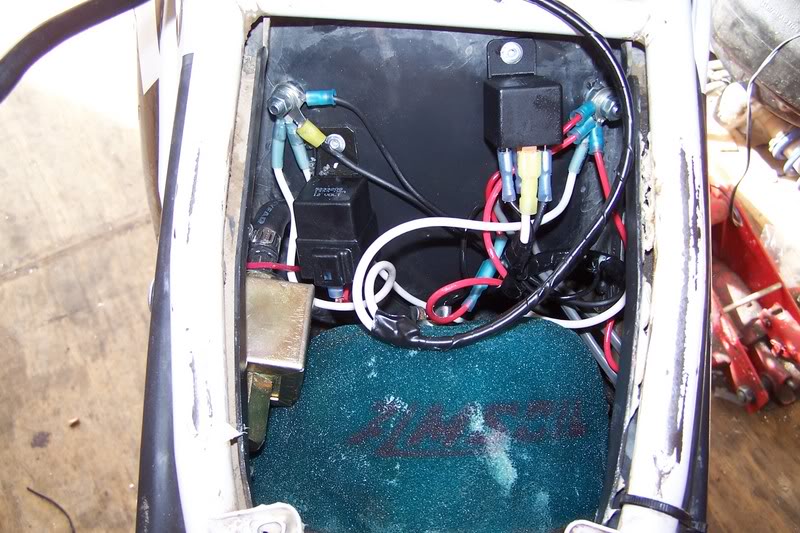

Airbox crammed with the solenoid relay, fuel pump relay and fuel pump...
![100_2529.jpg](/content/proxy.php?image=http%3A%2F%2Fimg.photobucket.com%2Falbums%2Fv681%2Fbritincali%2Fnitrous%2F100_2529.jpg&hash=dc14dcbcccf7cb5eaac1578057b881db)
Solenoids...
![100_2530.jpg](/content/proxy.php?image=http%3A%2F%2Fimg.photobucket.com%2Falbums%2Fv681%2Fbritincali%2Fnitrous%2F100_2530.jpg&hash=a84d863df5e17194d0e487673d414338)
