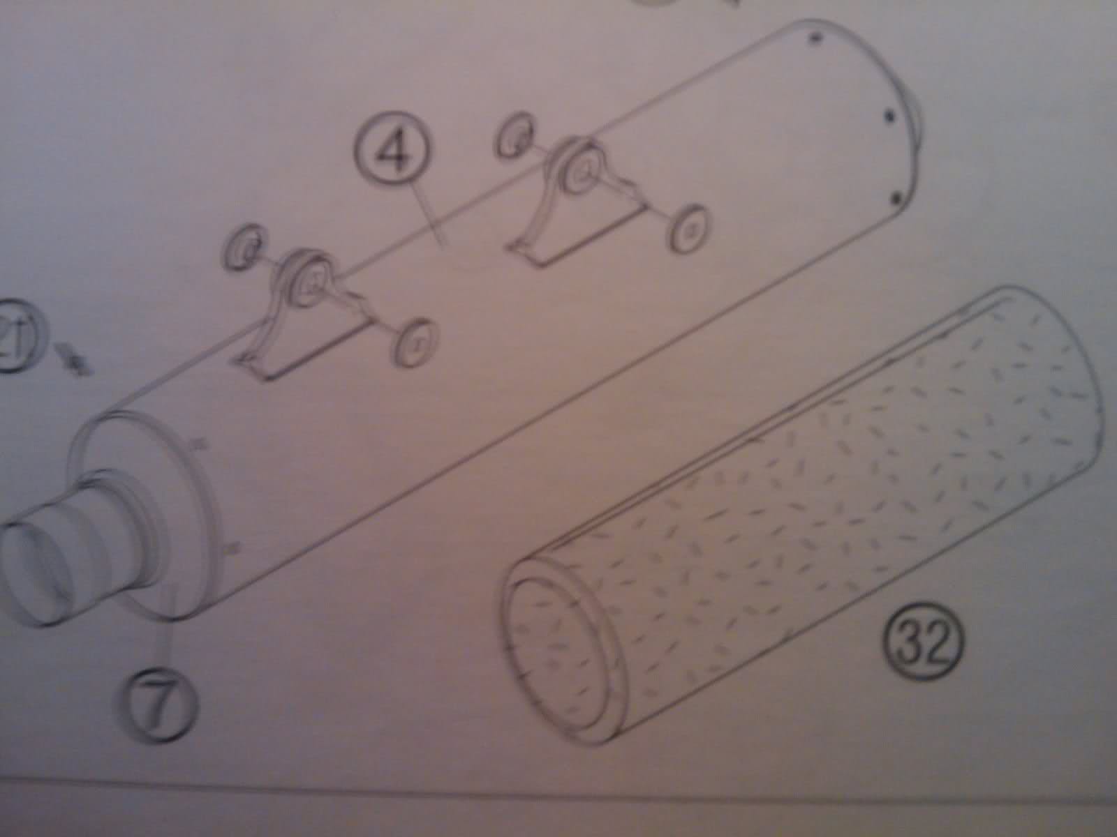

it is not its rivets... i know me and PBK where comparing and his bike is allen screws... mine is not .... here is a diagram from my parts manual...
if that even helps at all. but in then manual it calls all those little holes at the end dummy rivets
according to the website that is that right one, and install is very easy...drilling out a rivet is easy, and installing a rivet is easy...you can do it.
