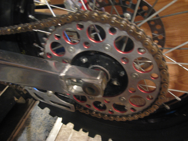

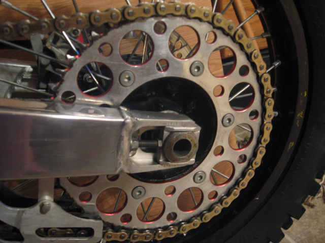

Well this might help show how far back mine currently is set. I was to lazy to take out some links so I just pushed it back.I've been having issues with cornering after I changed this, this could be the fix.

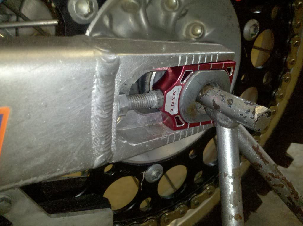

Is your chain still within spec James? Cool axle block blingage.![]()

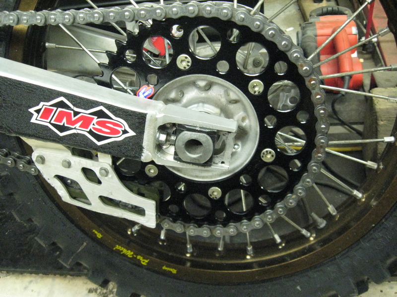

You know its just amazing what removing two links out on a chain will do for you. Stock on my bike is 114 links. But I have been known to run a 51 or 52 tooth rear sprocket so 116 links is perfect. But Im currently running the stock 49 tooth and the axel blocks are near the back of the swing arm. Its a new chain so I may have to take out two links.
