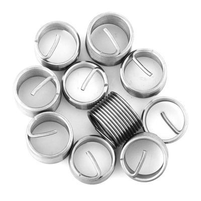

Well, the head is puffing soot and looks like a blown gasket again in the same spot... so i started to take it apart and the head bolt on the left side wasn't tight... ok, seemed odd... continued to tear it down and noticed there is a helicoil in that bolt hole in the cylinder .... I assume the helicoil didn't hold or slipped... is there a way to remove the helicoil and what recommendations to get another helicoil in and to stay put? I don't want to buy another jug if I don't have to because the piston is new and cylinder was just honed. Thanks for any advuce
