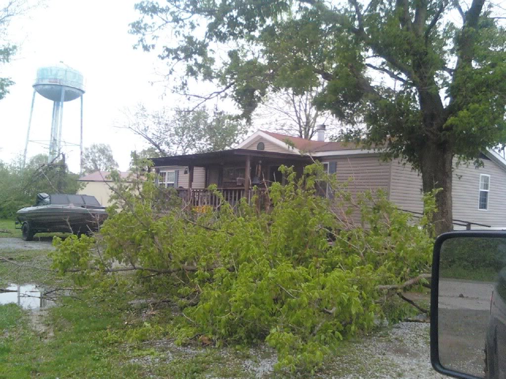

Bigass branches all in my boat.. moved it about 20 feet also..Put a few scratches on my truck... Threw one of my dirt bikes into a field...

This is the crap i pulled off my truck

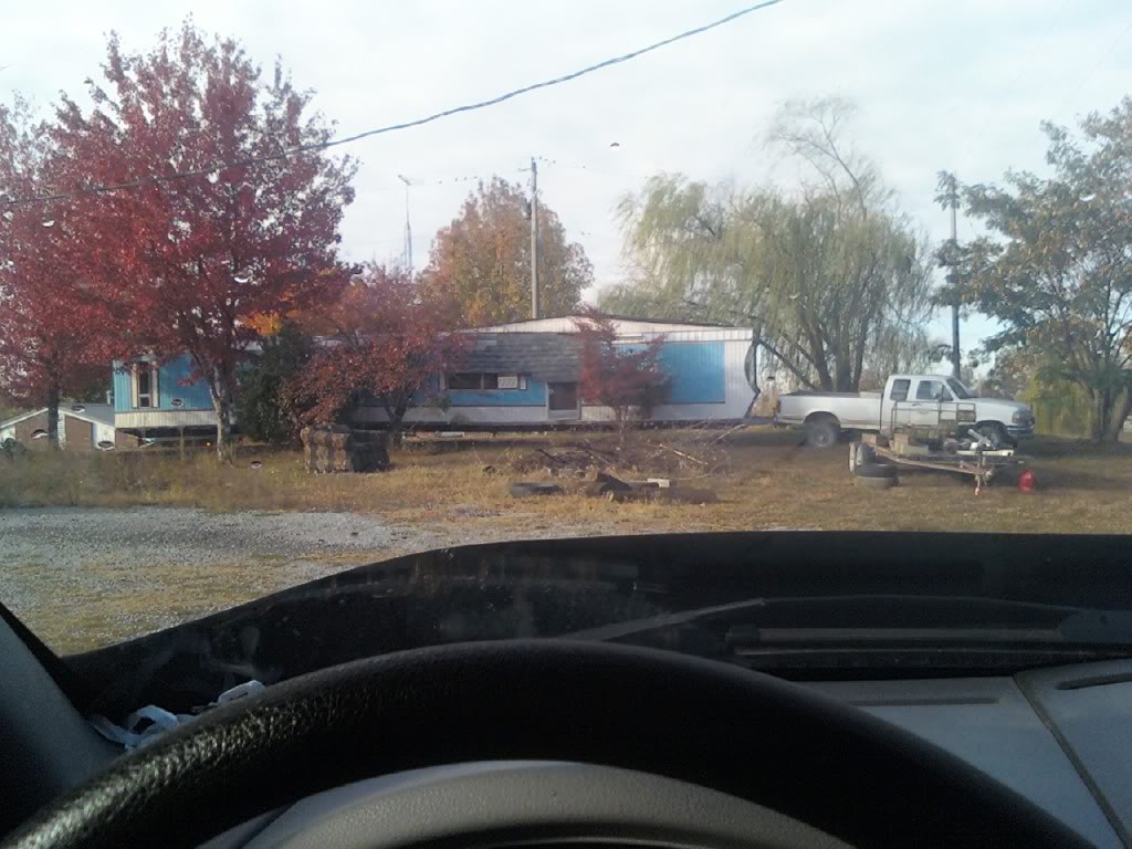

This is a mobile home of my buddys we was going to put on his property this summer.. i moved it from where he bought it to my property while he got his property set up for it.. This picture is while i was moving it to my backyard... few months ago

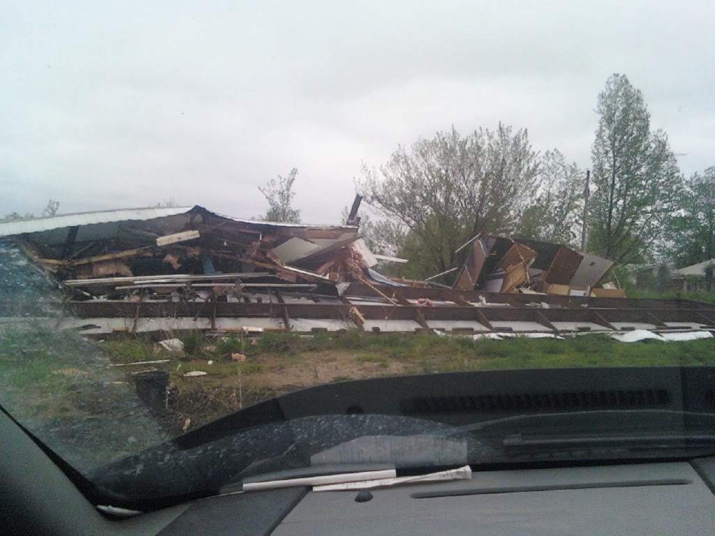

This is what it looks like now
