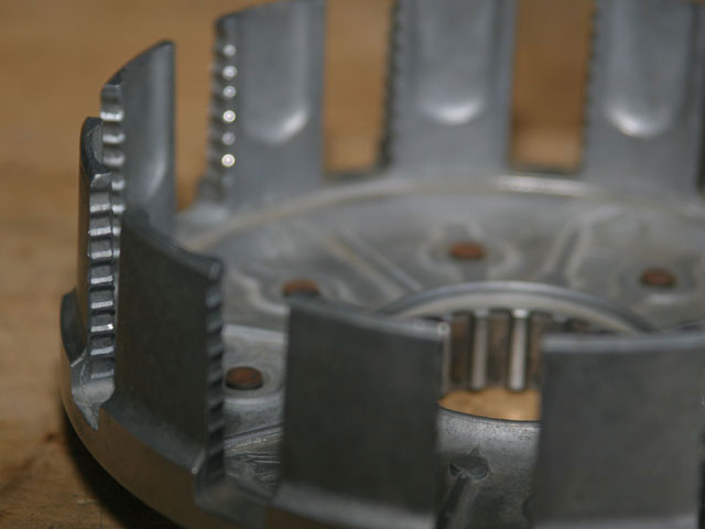

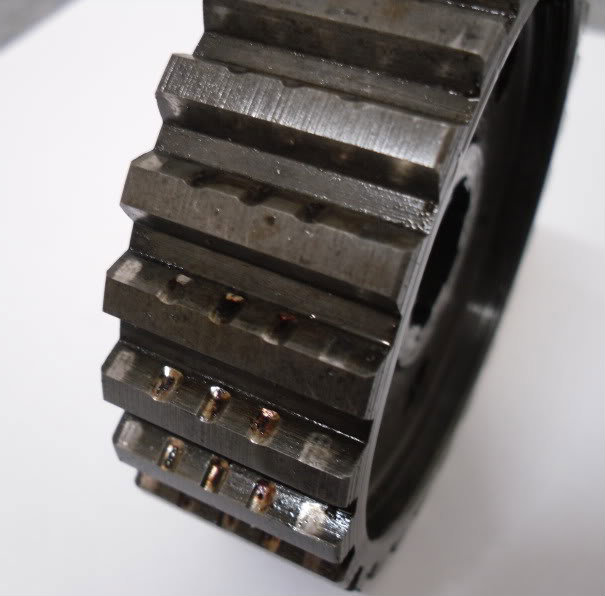

what do you notice specifically that feels better when using ATF over motor oil? My 05' RM has slightly notchy shifting, and the clutch has always been grabby, I'm gonna try ATF on the next oil change, just curious what you noticed.
Oil won't fix a crappy basket...
I feel the ATF makes it more sticky.More positive.
Oils make it feel squishy,Feels like it fades. Feels like the clutch is slow.
Have you checked your basket and hub?
Those notches are not supposed to be there. That is usually what cause a grabby/notchy feel.
Had it apart at least once a year, for other repairs, looks and acts the same it did new in 05. I know it's a shitty basket, even new.When it goes to fubar status I'll go with a Hinson basket, sorry you Rekluse fans.
