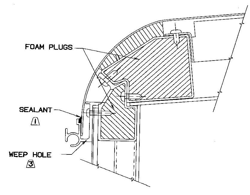

What? Your end cap on the coach broke off in the wind? Pics? Details? Never heard of this sort of thing happening.
not end cap, entire top cap of roof-one piece glass roof
You have a Winnebago by chance? If so, there are some things that need to be checked regarding the roof and how it is sealed along the sides. One piece roofs are great but needs some maintenance. :noidea: I had a situation on my 1997 Adventurer like what happened to you and the insurance paid for the repairs. :thumb:
yes it is an Itasca made by Winne. Just got it from dadinlaw, only 14000mi, been sealed once already. Insur est $5400...at shop now to see what their est is.

I have been using this on my 2014 Itasca Sunova as it had some areas around the rear cap that the side seams had cracked. If you can push in on the roof from the channel it is tucked into then it needs to be cut out and re calked. This stuff works great and is not a silicone base material that they say not to use.

Very little maintenance required on a Winnebago figerglass roof. BUT, the absolutely critical thing on a Winnebago roof is the sealant at the seam along each side where the roof meets the sidewall. That is a mandatory annual check/repair as needed to maintain the Winnebago roof warranty. When you push inward on the roof fiberglass at the sealant, if a gap opens that sealant needs to be removed and replaced. It is a urethane based sealant/adhesive ... NOT silicone. The result of completely ignoring this sealant can be the roof peeling off while driving or during a strong wind storm.
