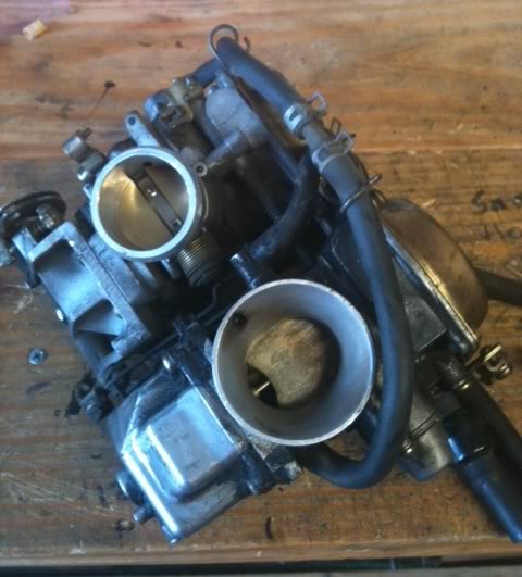

there should be a linkage mechanism between the 2 carbs that have a screw adjustment. It usually takes a special tool to make the fine adj and tighten down lock nut.
Will adjusting that one link make both the carbs synced? I know that four cylinders have them to sync. I haven't had time to try it out lately, but once I get to it ill give it a shot. I think its just a Phillips screw driver. I'll take a look and give it a shot. Thanks
what it does is equalizes so both carbs have the same vacuum pressure....makes it idle smoother
if you look close by the bottom of the float bowl you can see the adj screw on my wifes virago carbs
