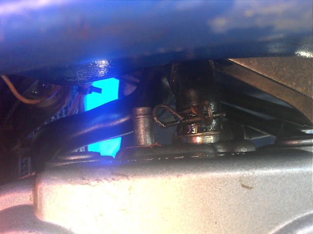

the tube right above the red rad hose and the silver tube coming out of the top of the engine...
Glad you said it...The nipple?
nah not yet... looked through the garage and found a bunch of clips for wires/tubes but didn't see a spare hose...lol.did you get it fixed?

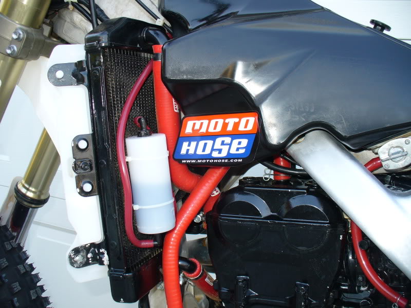

The crank case breather hose attaches to the top of the head runs down the frame by the engine....like shown here in the RED hose on my 08 450
Thanks manI was at Privateer Connection and they had a YZF like yours so I asked where that hose went.....he said its a breather that goes from the valve cover to the fitting that goes to the oil tank in the frame.
