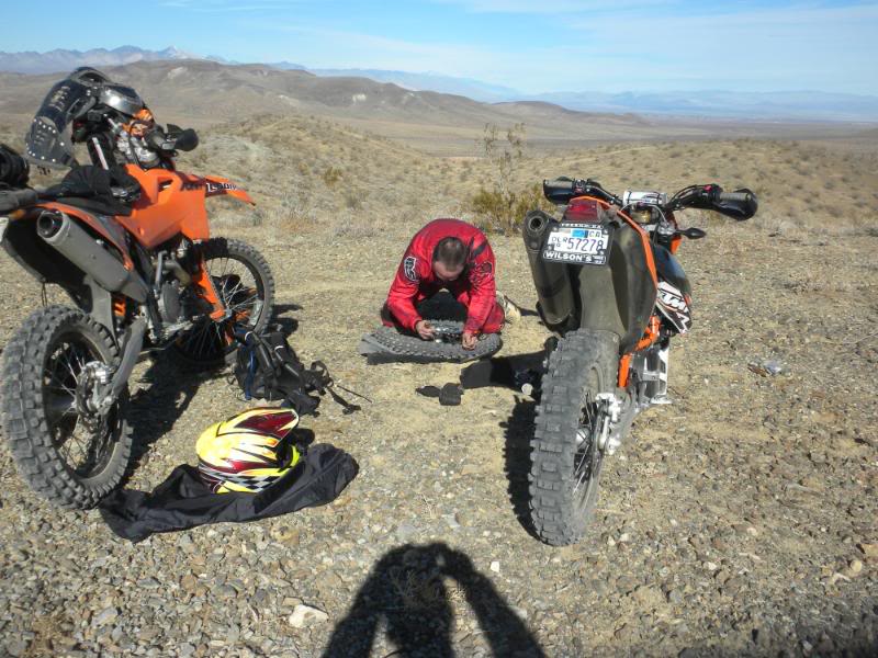

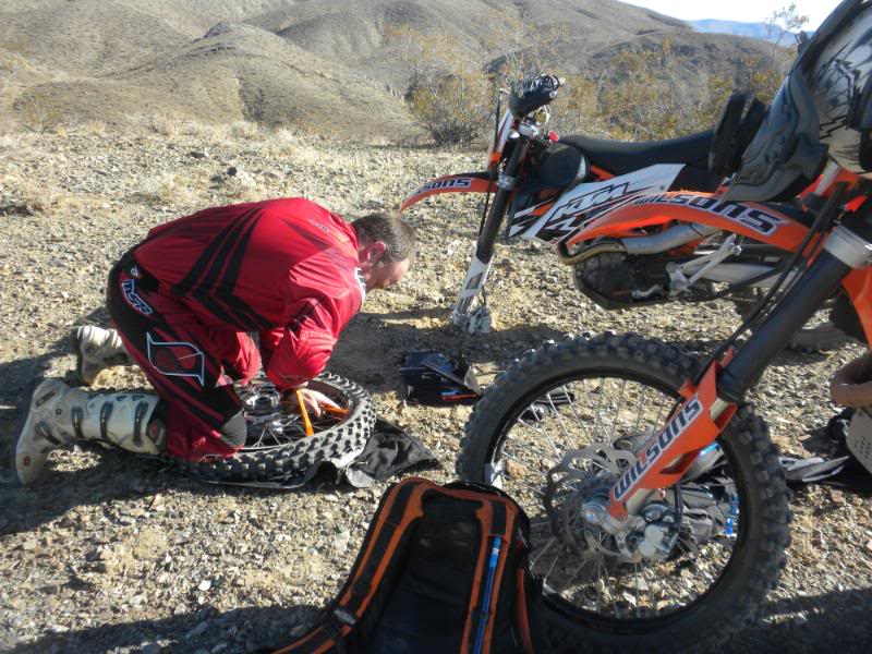

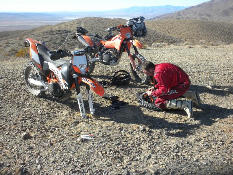

okay here are a few pics of some trail side repairs....

I love those tire spoon combos. I have the exact same two but they are not orange. I especially like the one with the little lip on it. Those puppies and some Co2 and you are golden. I usually lay the bike on it's side though or try to find a log or rock to set the bike on.
