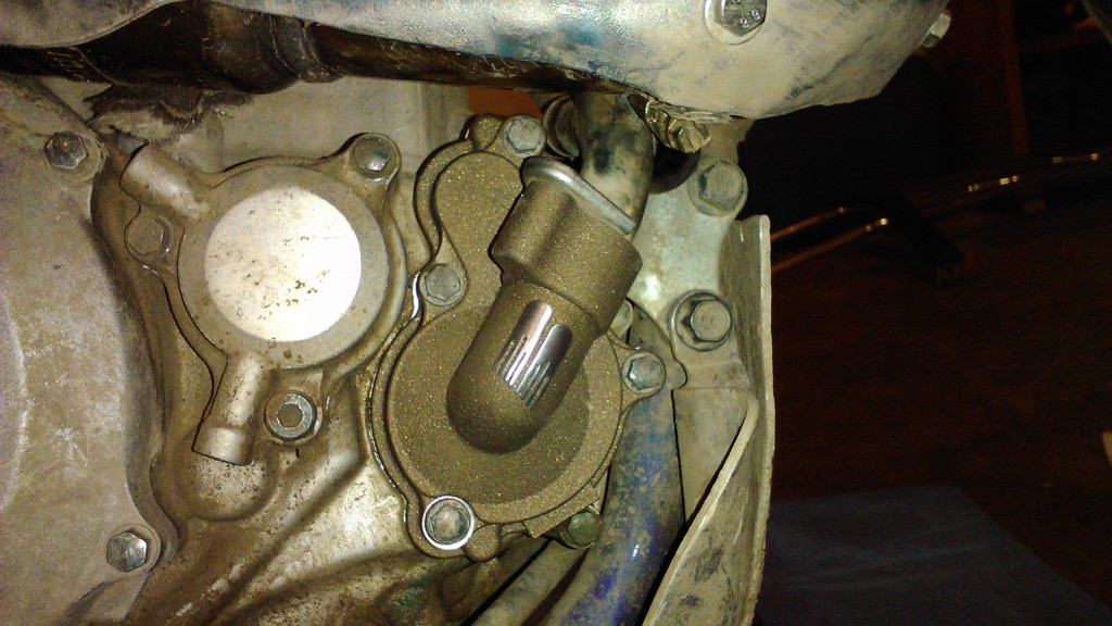

Pump cover Boyesen on left stock on right
