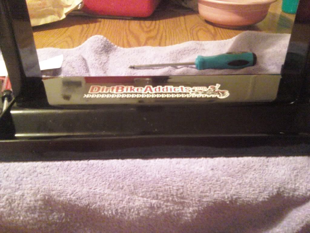

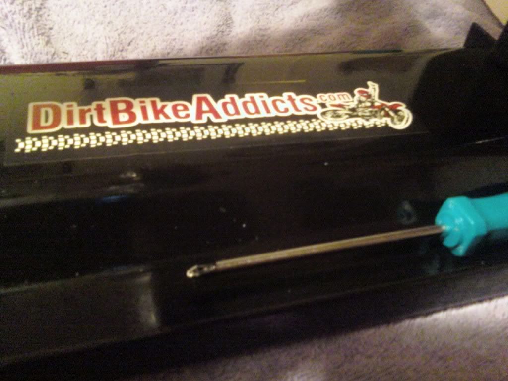

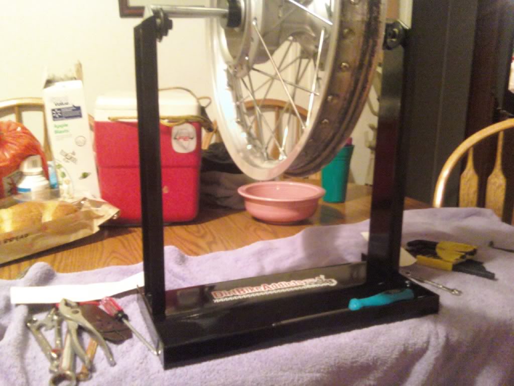

Can you take a picture of the wheel holding mechanism? I'm interested in how it holds the wheel laterally. -BIG DAN
Sure ill take some more (and better ) pics tomorrow... Harbor Freight had that one for 49.95... i thought it was a great deal.. you could make it very easy......

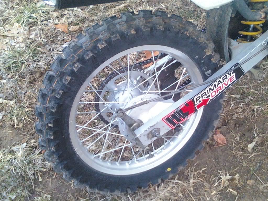

Well i got it completed today... Everything looks and feels perfect.. I dont really know how tight i need to tighten the spokes really tho.. I told her to take it easy for a few days.. Im going to check over everything for a few days...

This wheel was off to one side from the factory...

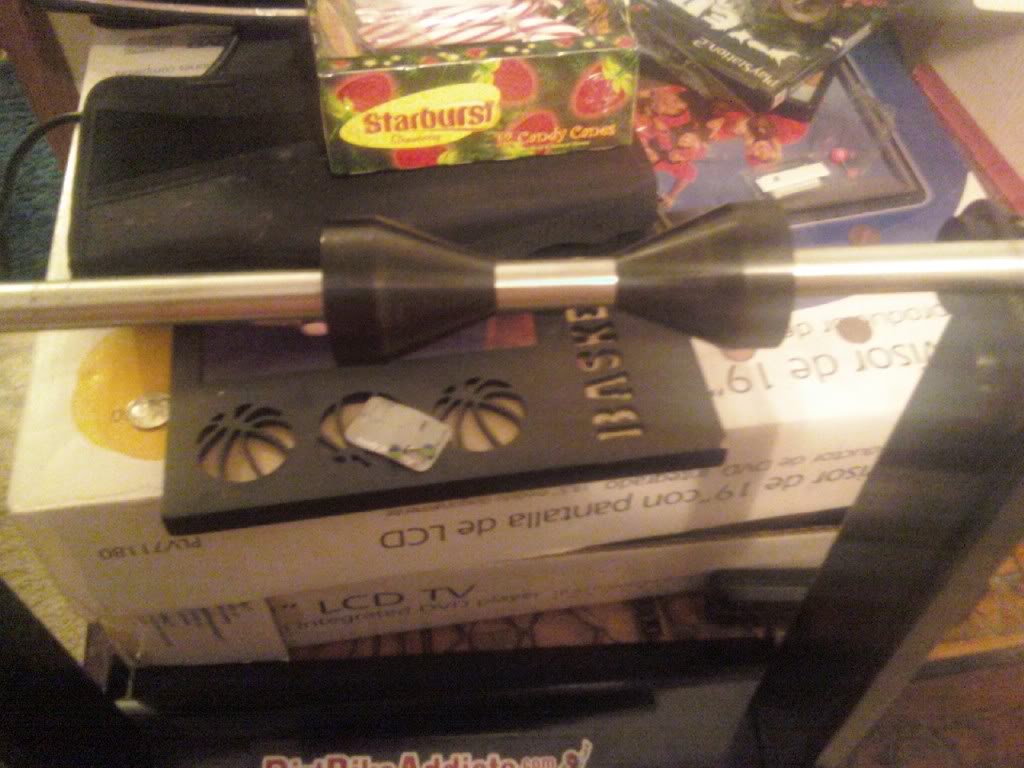

that shaft there that had the two black sliders
You have to take the bearings out of the hub and the sliders slid into the bearing housing and the sliders have little allen screws in them.. tighten them down and it keeps the wheel solid to the shaft there.. and the shaft rolls on the rollors there
