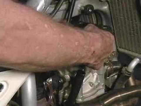

You should see how easy the Husqvarna of Cagiva was up to 2011. After removing the usual, remove a clip, slide rocker off, replace shim, slide rocker back on, clip. done.
This will make you cry.
Genius I tell you!!!
