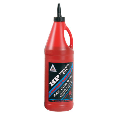

Tylerdb: Like Naturaledge stated. You will get multiple answers. The best info you can get as to what type of oil to use in your gear box, is run what the manufacture says too. You stated 80 weight gear box oil. Well yes and NO. PLEASE do not go to your local auto parts store and get 80 weight gear oil. That is not the right stuff to use. Use this stuff. http://www.rockymountainatvmc.com/p/58/-/295/935/-/4279/Bel-Ray-Gear-Saver-Transmission-Oil
Or this stuff http://www.rockymountainatvmc.com/p/58/-/295/935/-/11719/Pro-Honda-HP-Transmission-Oil
I use both. Truthfully I cannot tell the difference in performance or shifting operation. However I will say this. You will know when you have the wrong stuff in there. Your clutch and your shifter will tell you if they like it or not. And as Naturaledge mentioned. Change it often. How often. Well that depends on how much and how hard you ride. I usually change mine about every 5 rides or 10-15 hrs of operation. When your clutch starts acting up or shifting becomes difficult thats where I go first is check and change my gear box oil.
