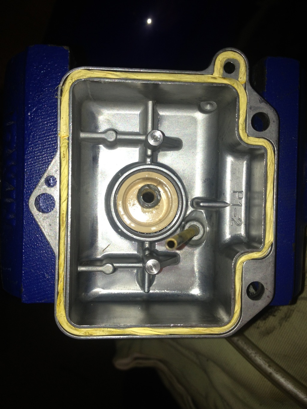

I like the tape too but I'd never put it on a fuel screw. Threads too fine and application too sensitive. The tape works best, in my opinion, on threads meant to stay put, not adjustable. I put petrol resistant tape behind the o-ring on a needle valve seat once, that worked really well. Also like to wrap crush washers and get a few more uses out of them. Here's a pic of one of my more inventive uses.
master hack
o-ring tore while coming off so I threw this together. New one came in days later, still have in the pkg if this ever leaks. Going on about a year now..
