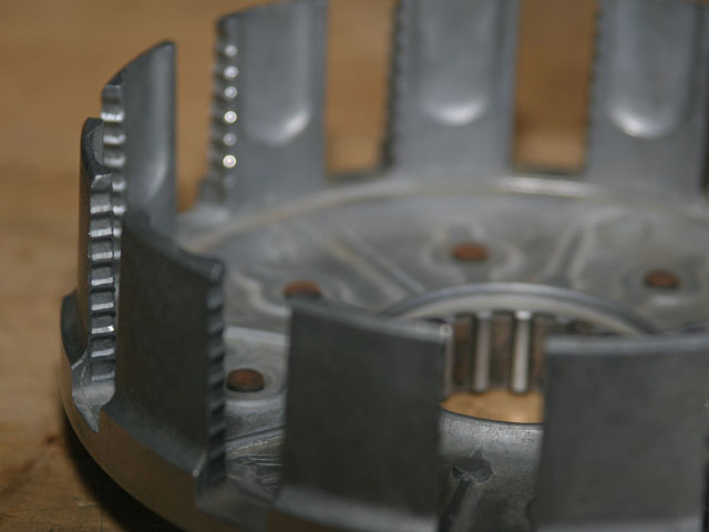

Was the basket worn with deep notches like this?
I don't remember seeing anything on the sides. There were at least a couple of the stands with a slightly beveled end.
Could I just pull the basket and use a grinder to remove any groves or will that create too big a gap for the friction plates to grab?
update: After cleo's post I checked out pictures of a good basket. Never even thought about that.
Going to go open it up and take a look.
Thanks to both you guys for the advice.
Wow... never thought to look, but haven't ever owned a bike that's so old.
gonna try to find a used one at bent bike.

Sorry to hear of your loss. The grooves prevent the plates from disengaging from each other. You can file down the notching but it makes the clutch package slop back and forth between forward acceleration and engine braking. Not a huge deal, but can groove even faster with the slop.

Did file down the fingers today.
