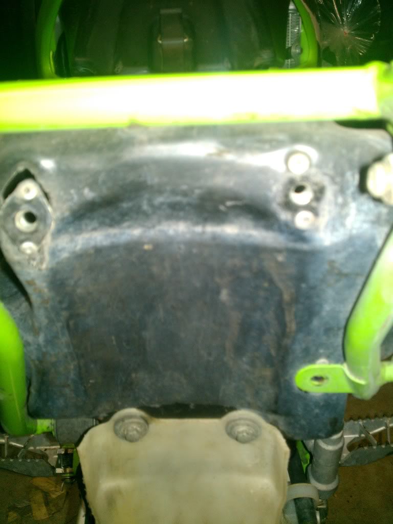

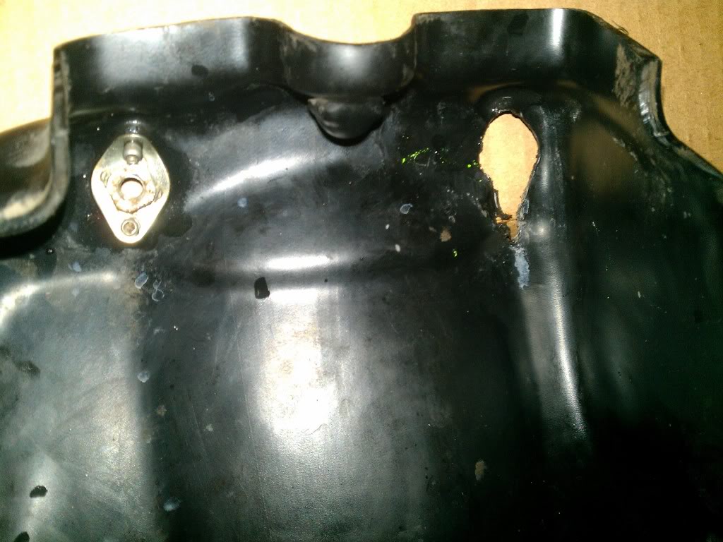

SIDEWAYS! why have I not thought of thatThat's a good idea, I think I'd rather fill in the gaps with some epoxy. I'd think great stuff would expand FAR to much. But that stuff is indeed great
Well what you do with the great stuff is put a backing plate. Like card board or something tape it into place on the inside so it wont expand into the box. Then once its cured. you can sand it of or use a razor knife to cut off what you dont want. You will have to do the same on the inside a little but it will help strengthen that weak area also. Or you could just use epoxy but use the backing plate like a suggested before. Either way should work great.

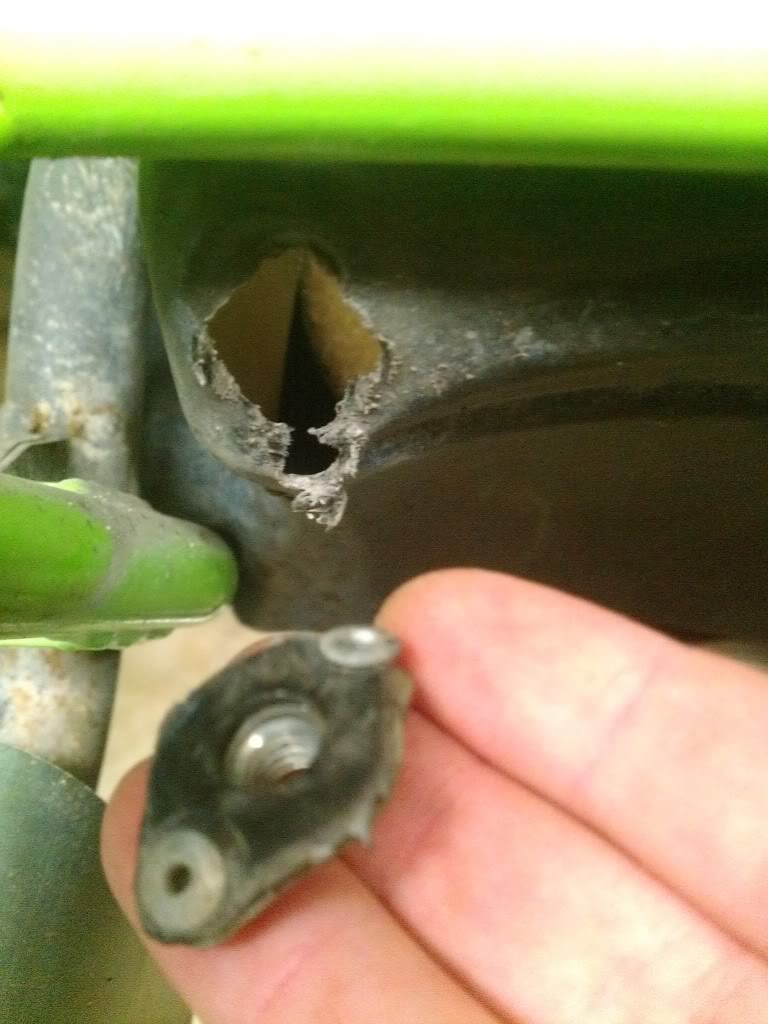

The plastic came off around the rivet, so Idk if I should clean up the whole and epoxy a piece of plastic in to patch it, err plastic weld it, err do exactly as smoke said.this happended to my 125, and I used some lacquer thinner to 'plastic weld' it back on... give it a shot... but be careful![]()
