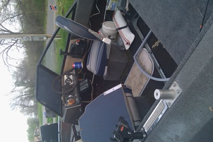

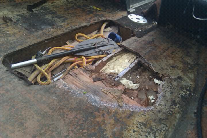

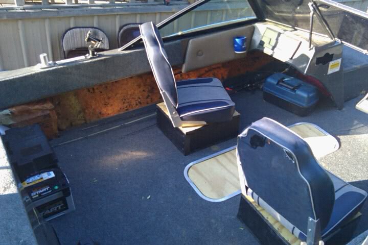

This is after winter storage first look :lol:

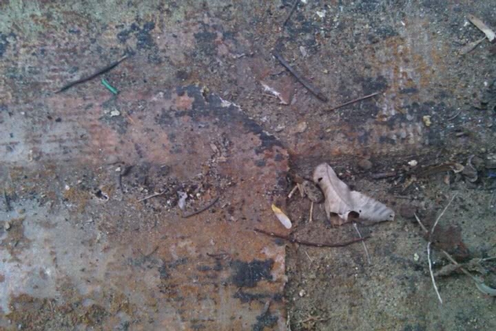

Crack in floor.

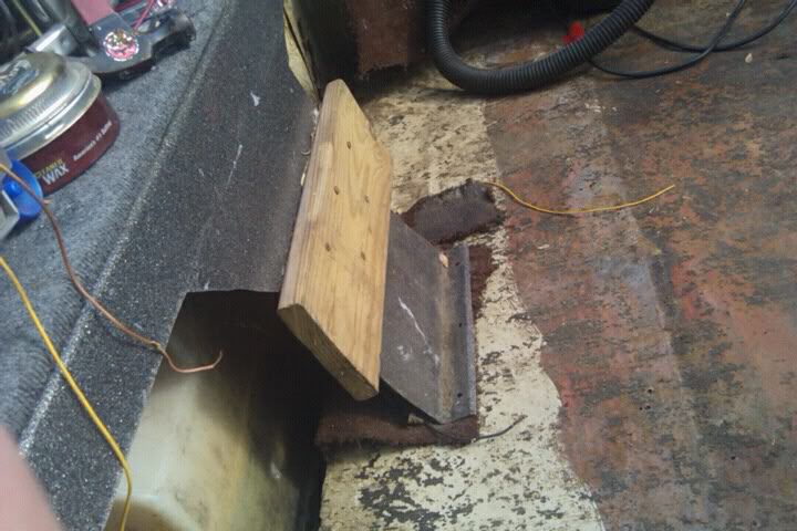

Under drivers seat :cry:

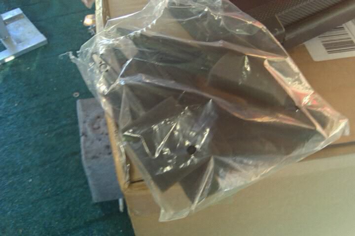

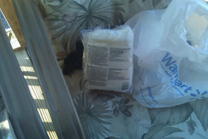

I called this kitten hair... Its like the welding rod for fiberglass :lol:
Original floor was 1/2 inch.. I replaced it with 3/4 and Had to fiberglass the whole floor in.

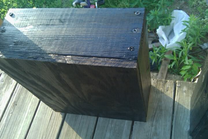

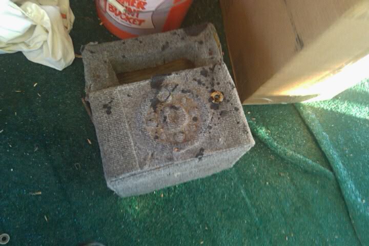

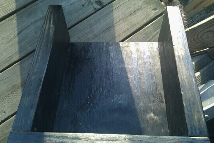

Old seat boxes. (storage sucked)
Will cure anything (but toof aches)
Seats and new seat boxes... Much more storage..

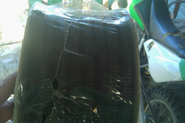

50 foot of wireloom

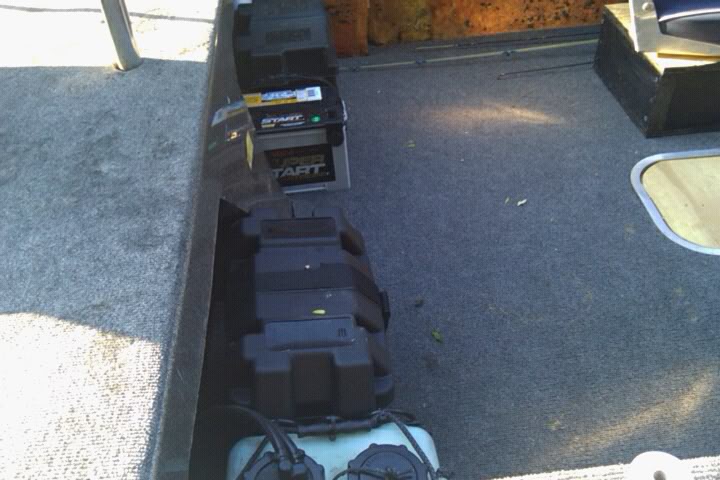

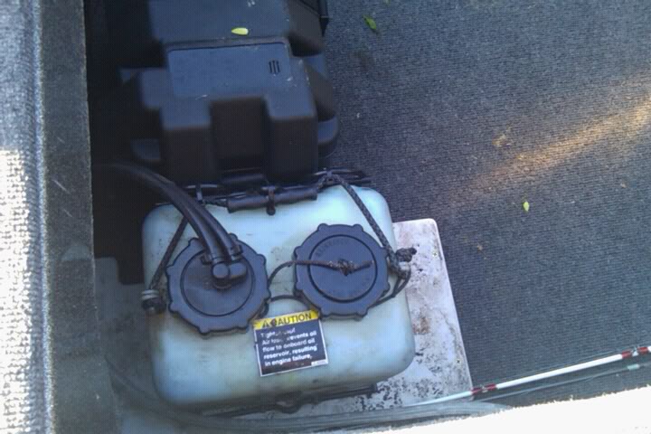

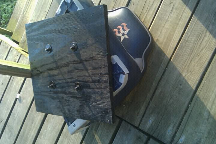

Converted the boat from 1 battery to 2.... The second battery is on a switch... All the accessorys are wired into the 2nd battery.. And the main battery just starts it.. I still have some wiring to do once i get my LED's
New battery boxes and batterys... (BTW Marine batterys are exspensive :cry:... Specially 900CA )

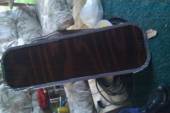

Center section that i stained and cleared. And i'm going to pull the carpet off alot of the interior and just stain it the same color.
