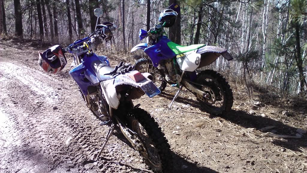

lets see some recent pics of your WR450 :devil:
Here is the latest I have. That's my WR furthest away, and my brothers WR is the closest one.
