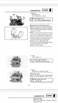

The fuel screw, probably 2 turns out from lightly seated will get you in the right direction.
Float setting is something like this...
