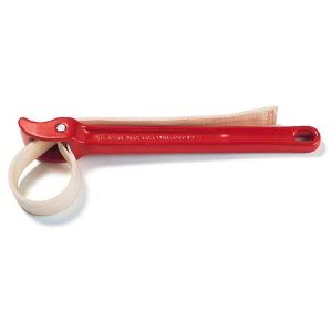

one of those cheap belt holder tools/pipe wrench with a belt, things can sometimes work. Get them at the discount auto parts store for cheap, or Harbor freight. I use and air impact for the bolt and the proper puller for the FWW.
