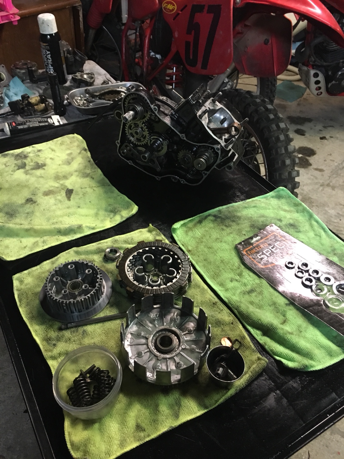

Been pricing out cylinder work for my new sleeve installation. I’m going to reinstall my current setup with a hone and new piston and rings. I want to make sure the bottom end is good before I drop $400 on the top end. Hoping to have more done tonight.
Sent from my iPhone using Tapatalk
They aren’t in good shape. Don’t know if it’s due to working all day and staying up all night, but I can turn the engine over with a socket on the crank, but the Kickstarter will not move it. Not looking forward to the investigation. Any ideas?
I forgot to align the kickstart shaft. Fixed that. And is it possible to have the inner basket too tight? When I loosened it a bit, everything worked again. I have not installed the clutch plates to check for function. I’m also having a very difficult time getting it into neutral. I had it in neutral before I put the clutch components in. I think im trying to cram too much stuff into my day right now. Forgetting things. Hopefully that hasn’t caused me to damage anything. If it has... cases coming back apart. Any input on the clutch question would be wonderful
Balls.. I think I know what it is... I’m pretty sure I installed an extra washer in the tranny. Should be on the shift shaft. Well, I think the rebuild will go way faster this time around. I just read another thread and that makes sense. If I don’t torque it all the way, it works. Otherwise, nope! Tickle my pickle and (insert some bs). I need more rest.... fook
Or, I could just have the washer on backwards. Apparently that makes a difference too. Screw it im going to try everything. Easiest to hardest. Sleep deprivation is really killing me right now, I’m gunna shut up. I’ll post what I find when I’m not acting high.
