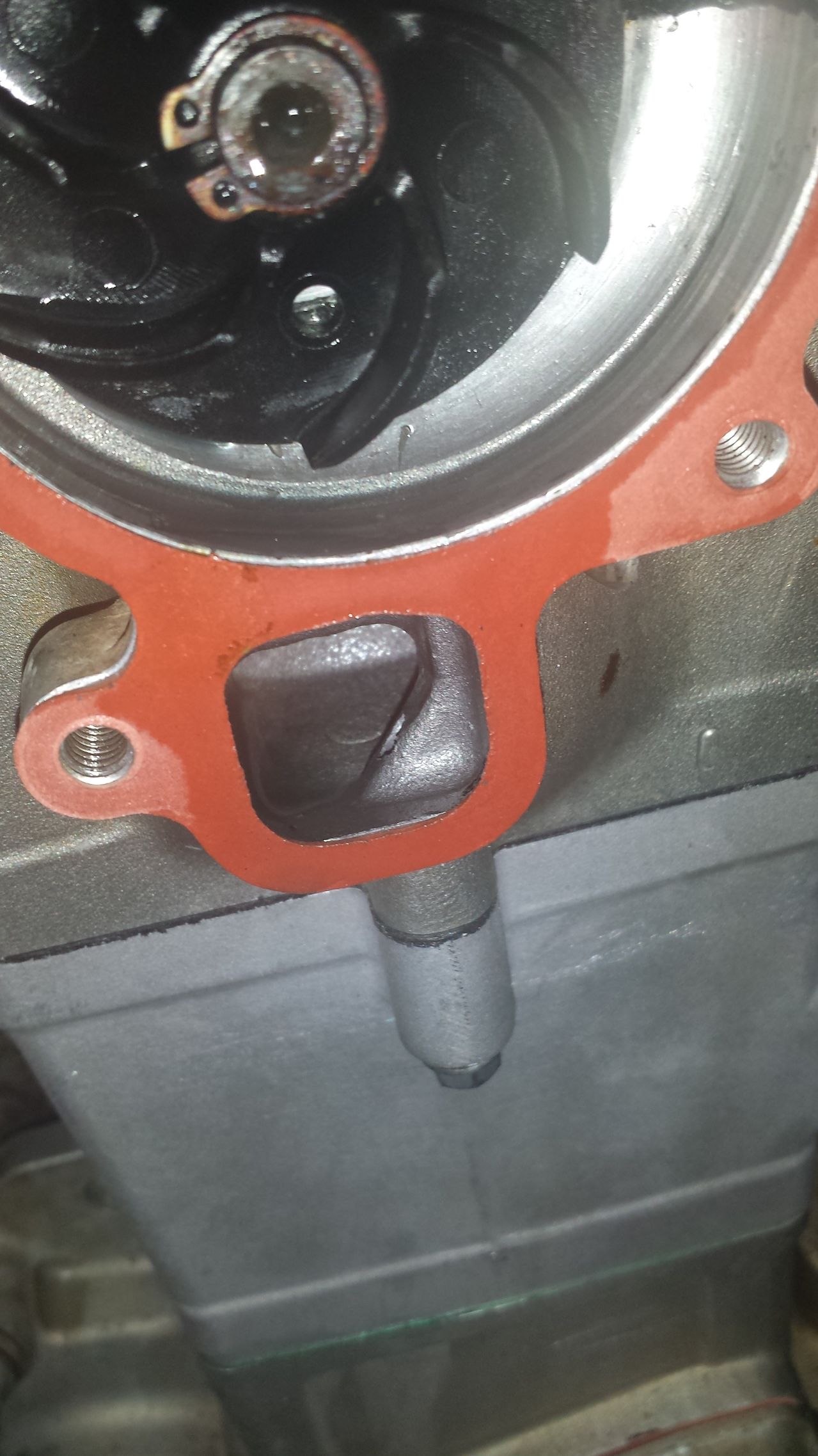

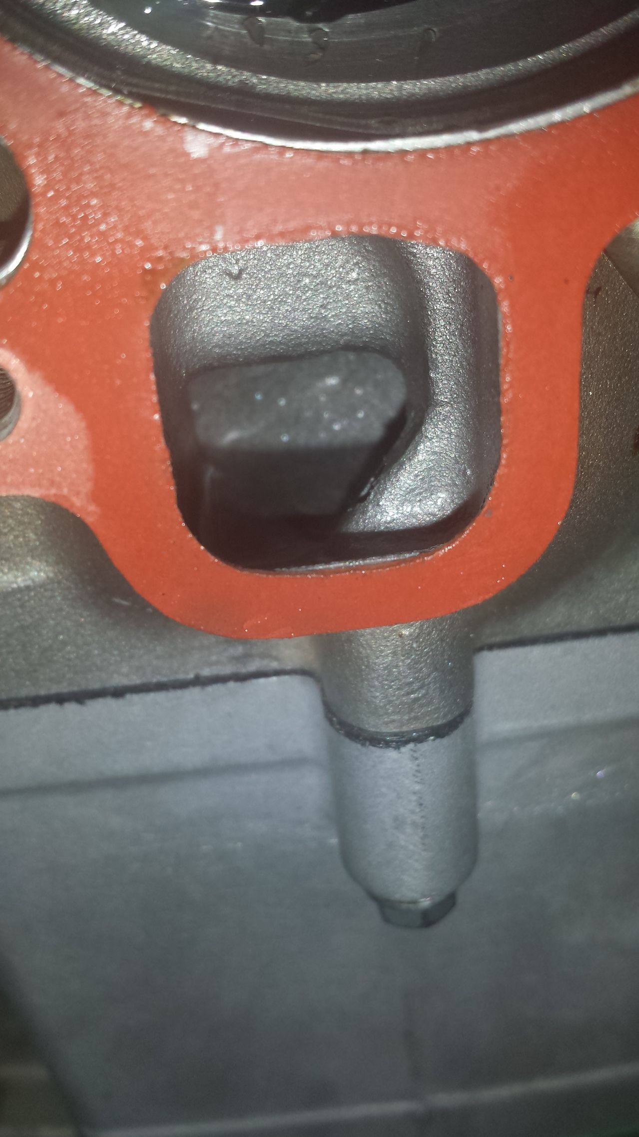

is there meant to be coolant/water in that little square hole/section under the water pump? i assume there is meant to be but not 100% sure or confident so thought i'd ask and make sure.
finished the rebuild nonetheless. had a very slight coolant leak from the head bolt underneath the water pump(bolt/copper washer wasn't sealing properly/evenly on the cylinder)...it was torqued down to spec but had to file a very minute amount off the bolt surface to even it out as it was a bit uneven and felt that way. fixed it up now though. all good now.
