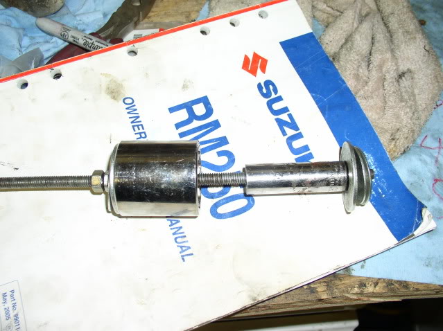

there is... I use sockets and a threaded rod for some seals and bearings.... you might be able to use just a socket and some light taps with a hammer.
