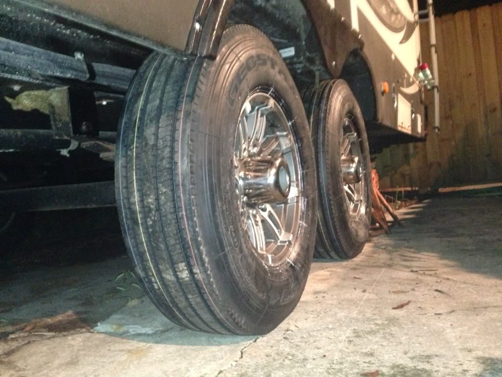

So my dad decided on GeoStar G574's. They aren't a name brand, but all tires are China tires these days and I couldn't find one bad review on them. They are really heavy duty and seem like they will hold up forever and a day.

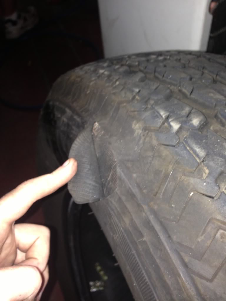

My parents were lucky to make it home on this tire. When they got home from their last trip I noticed the left rear had lost a good amount of air and leaked all the way down over night. Here's why.
We check the air pressure in the tires before each trip so they were treated right and still junk. Only a year and a half old.
BEWARE OF POWERKING TIRES!
Here's a picture of the new tires mounted up. Doing the right side tomorrow.
