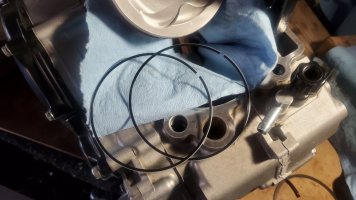

First picture, those 2 rings are seeming too big, so when installed, cylinder head will not go over it. The kit I purchased was supposed to be "install ready" so whats the deal?

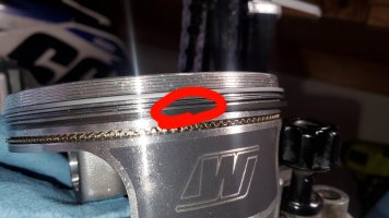

Second picture, of the 2 middle oil rail rings, do they BOTH go in the middle slot of the piston together?

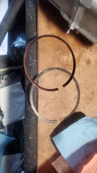

Check 3rd picture, I put both oil rail rings in middle slot together, is that correct?

You need measure ring end gap to verify they are the correct size rings for your cylinder.
RIngs usually go in this order.
-BIG DAN:thumb:
Ok. Had them installed wrong and pretty sure the top ring and 2nd ring are too big.
I will look up a video tomorrow that details how to measure them. So am I able to order rings my exact size once I find that out, or I need to get machine tool and cut em myself?
What initially confused me was my manual, it only showed 3 piston rings. Maybe just OEM has 3, Idk.
But it is normal for the Top and 2nd ring to protrude a lil and need to be pressed inward with my hand in order to get piston inside cylinder?
But based on image you shared with me, it has a line at 2 O clock and at 4 oclock, so Im able to put Oil Ring Expander either at 2 or 4 O'clock?
