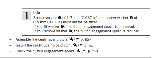

The manual states...
It may just be me, But sometimes how it is written, Can easily confuse you.....
If you fit washer, the clutch engagement speed is increased?
Does that mean , It engages at lower rpm?
If so.. Then i need to add a washer... To reduce the rpm that it engages, A little...?!?!?
cheers
SRAD97750
Moderator
More washers Higher RPM
Less washers Lower RPM.
The less spring pressure, the easier it is for the centrifugal forces to engage the clutch.
-BIG DAN:thumb:
-BIG DAN:thumb:
Ahhh.
So i can remove one of the washers, and that should lower the rpm it bites?
Since its still a little too snappy for her.... rev rev rev..... GO.. :D
She likes it to be more like her old PW50..... gentle kicking in and pulling away...
She feels like she has more throttle control that way.. Instead of ON/OFF with the clutch...

Okay.. had my daughter out on the local field yesterday evening... Yellow clutch springs in, and removed 1 washer...
PERFECT!!!
She is extremely confident with that setup!
It is crazy to see, when a kid is cofident with a bike setup, How much faster they are!
When i first bought the bike, the clutch bite scared her, and she was petrified of riding around, because honestly, it was WAAAAY too much!
But now... She rides straight off, and she was ripping it around the field.. Loved it so much, she just continued riding until we ran out of fuel :D
