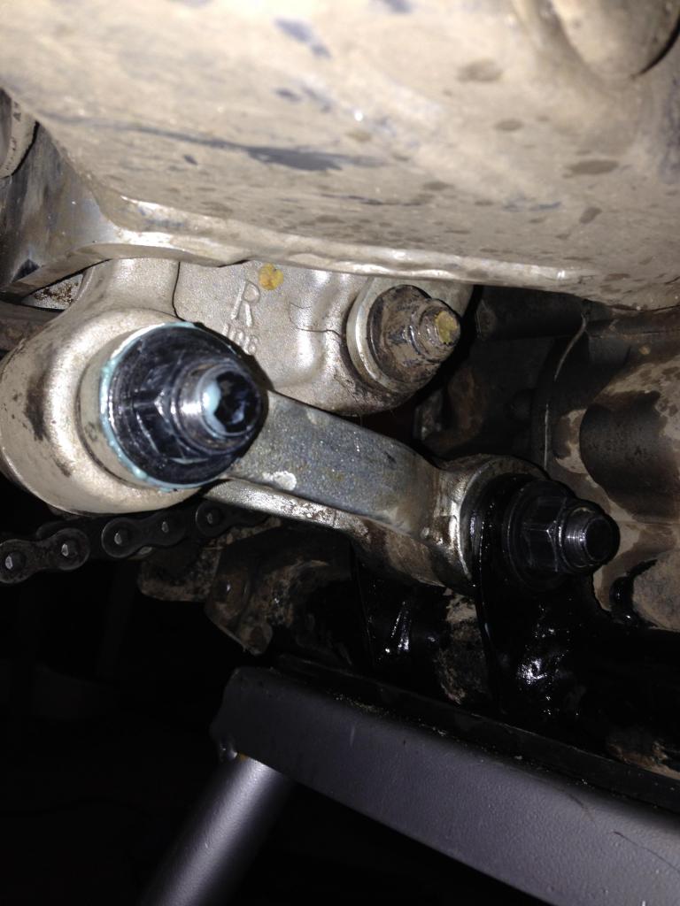

So in true form to my life where nothing is easy, the bolts are stuck in place. I am able to bang them backwards but I didn't remove them completely for fear of not getting them back in. I'm guessing once they're cleaned/lubed it'll be easy to get them back in.

Post a photo.
Which bolts? Don't pull out just any bolt, there may be pin bearings in there!-BIG DAN:thumb:
It also looks like the shock connects in the area of that top bolt. The blue you see on that bolt was a bit of grease I put on it to see if I could free it up a bit. The one thing I didn't try was lifting the rear wheel a bit to see if that helps.
Yeah, wiggle the rear wheel up and down as you manipulate the bolts. Don't pull the bolts out all the way, and just finger some grease in there. Then push the bolts back in and spin them a few times. That should do it. -BIG DAN:thumb:
No, no cracks it was just some dirt. I did wiggle the rear tire around a bit to free the bolts some. It wasn't enough to stop the squeak so I'll either have a go at the taking the linkage out for a proper wash/grease or run to the shop. I call the place I bought it and they didn't grease the linkage the factory did. Now I know, next bike grease linkage ASAP or have the shop do it before pickup.
