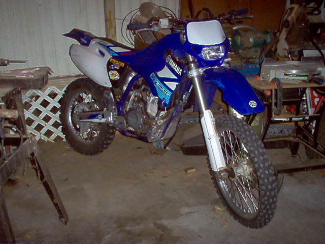

After my intial mods (FMF pipe, Powerbomb header, sharpie wheels and painted side plates)

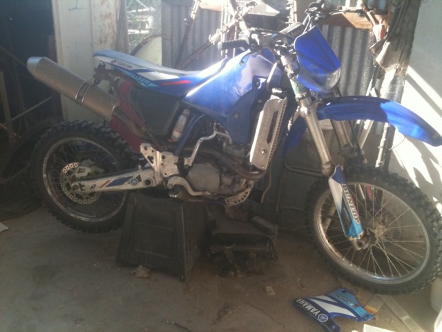

then i bought my of and let my brother use it... he sold it to a crack head and it ended up getting pretty bad:

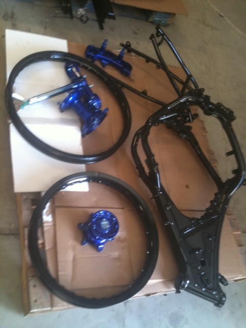

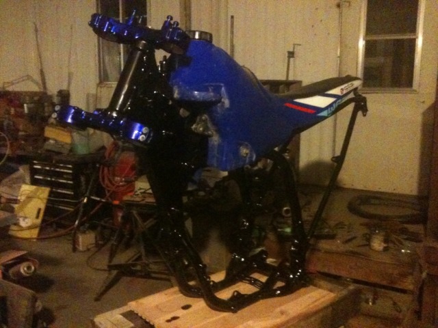

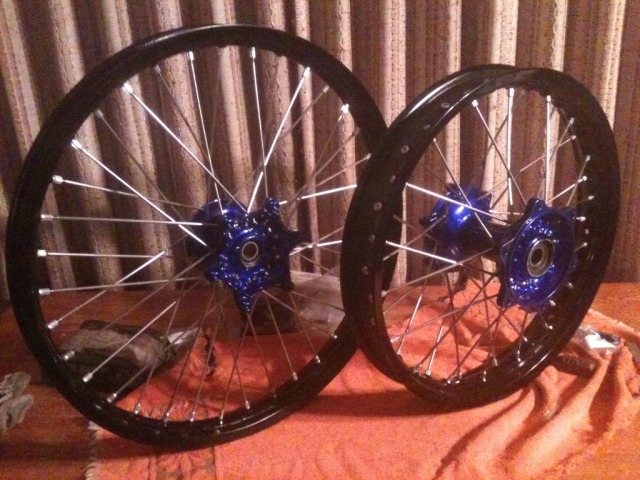

so i tore it all down to replace all the wear parts, clean the carb, repair the forks and get it powder coated. Thinking on what color plastics to get at the moment but just got the powder coat back today and I already laced up the wheels :banana:

well i respoked the wheels today and realized i'm going to have to do a lot of sanding/scrapeing to get some powder coat off. My sproket won't sit on the hub at all :bonk: . Put my triple clamp back on the frame but can't find the top nut... the biggest nut of the whole project and can't find it :noidea: got a whole 180 piece bolt and nut kit coming though but i doubt thats included.
