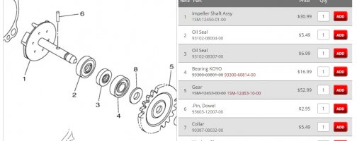

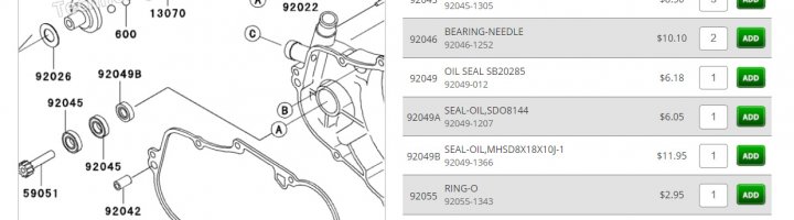

The yz250f water pump utilizes 2 seals, one for oil and one for water, both separated by a chamber that has a weep hole open to the atmosphere.
It would require both seals to fail, and allow fluids to pass over the weep hole chamber for them to mix at the water pump.
I guess anything could happen though... :noidea:
YZ250F double seal with weep hole cavity
KX500 Single Seal (fluids on each side of one seal)
