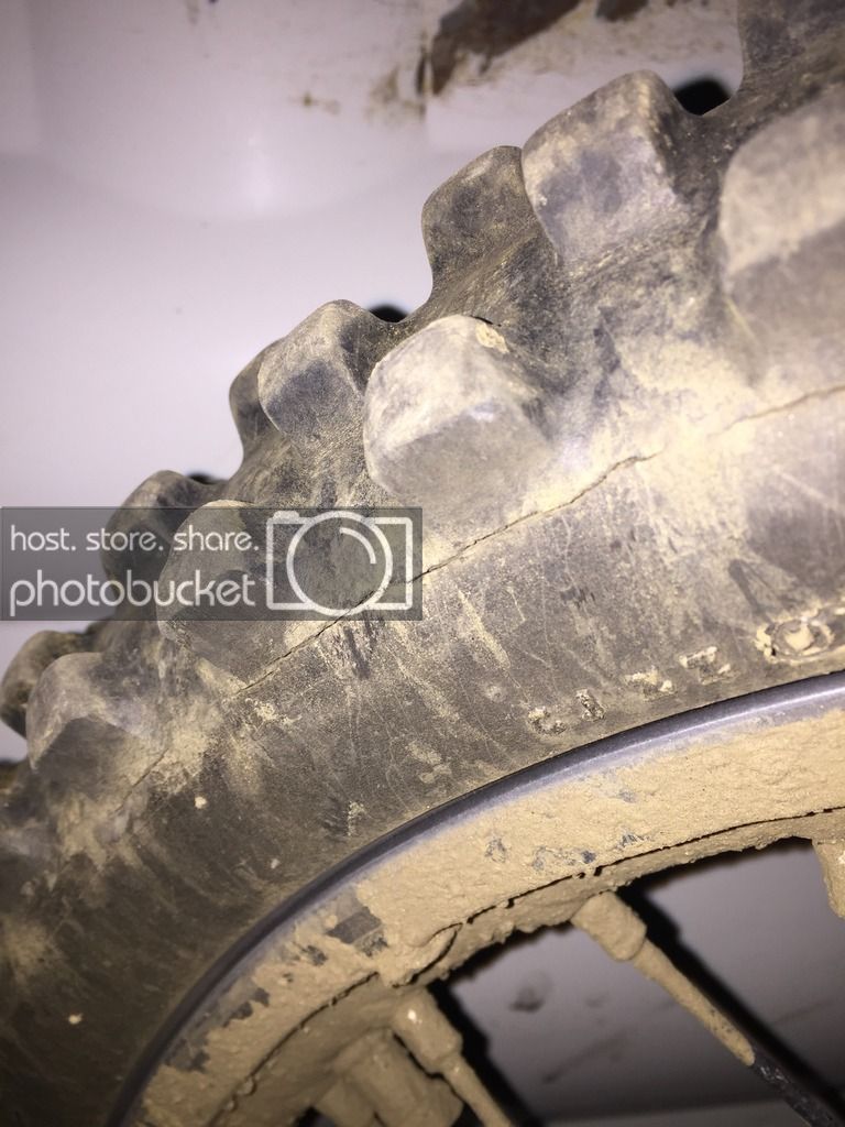

Do I need a new tyre

I wouldn't worry too much about tire failure as much as you would really benefit from having a new front tire. Those lugs are pretty rounded off and aren't going to bite well. When it comes to track riding it's all in the corners. Practice cornering and remember elbows up balls on tank push on the outside peg and lift your inside
leg. Don't get lazy! Good luck!
I personally would replace asap but wouldn't hesitate to make a ride day with it. The main thing is the the side will flex more so you won't get the same amount of bite.
