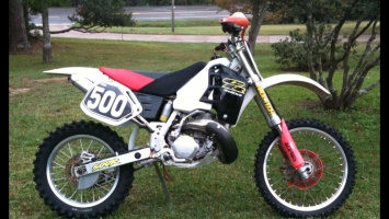

Wow thanks for the prompt reply guys. Would you say this mod made your bike easier to start? That video sure looks like it does. My bike has only 20 hours on the engine of desert fooling around. I am amateur weekend sand dune conqueror, nothing extreme:)
Here is a pic of my bike.View attachment 20137View attachment 20138
:wow: That is a nut cracker of a gas tank....
Sweet ride though, seems like the 500 smokers are coming around again.
