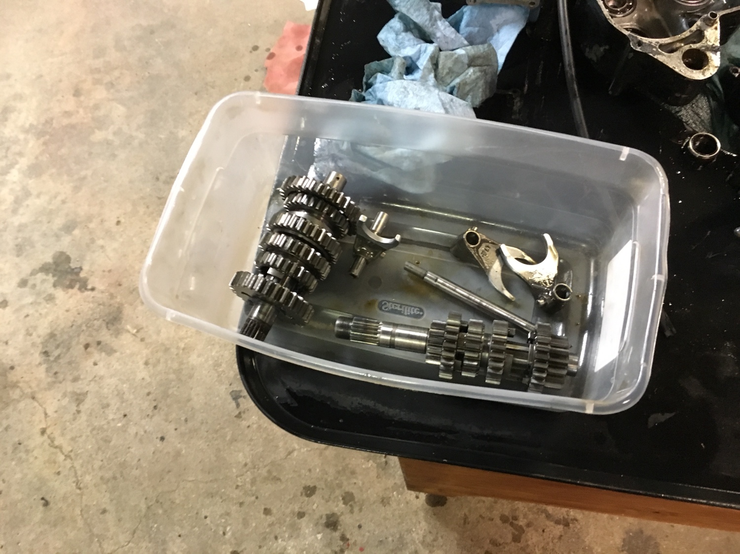

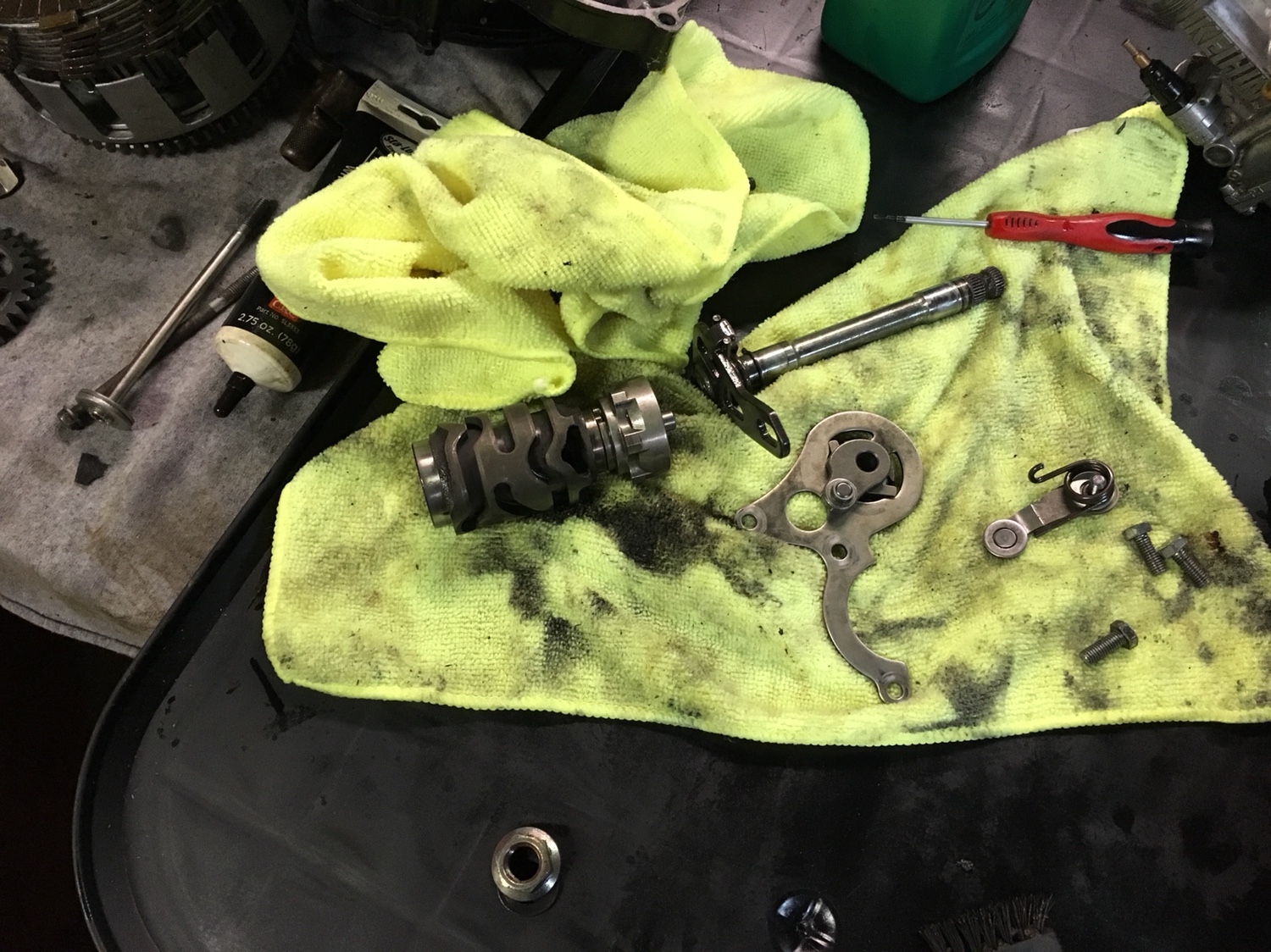

Progress! I think I figured out the order for transmission. Just need to put it all in tomorrow

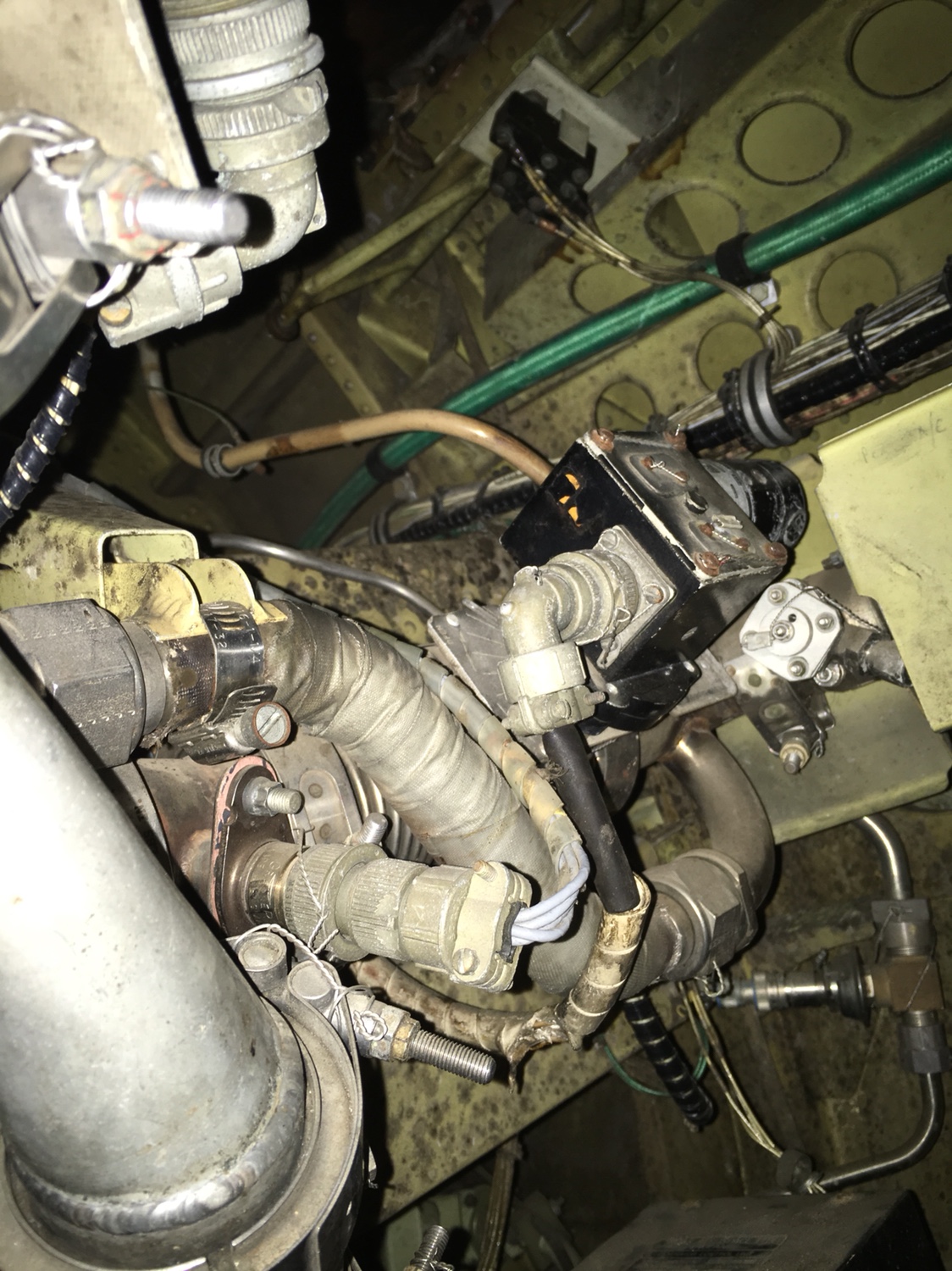

Not an ideal workplace but it’s what I have for now. College budget. And before you ask, this is what I’m doing in school:
That’s the “hell hole” on a hawker 125-400. No liberal arts crap for me... just Airframe and Powerplant certification. Don’t include me in this generation please... they suck

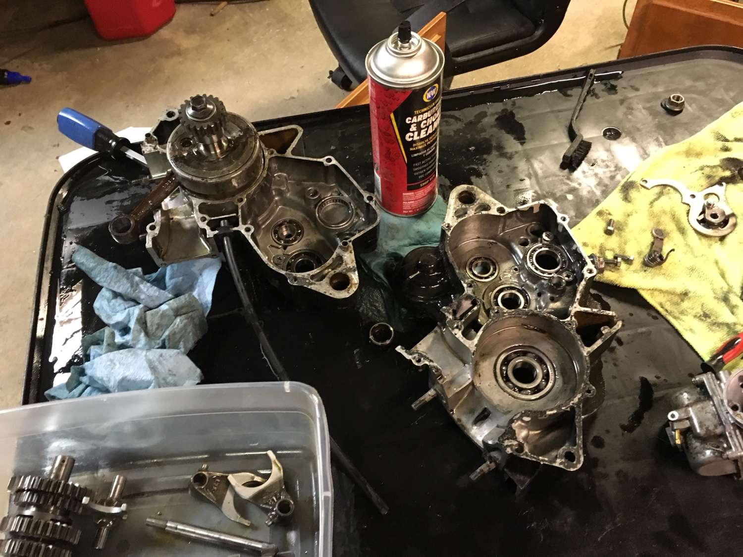

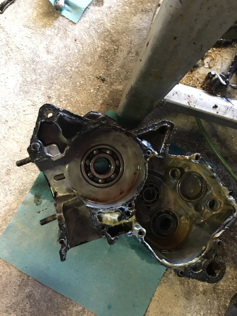

Looks to me like you got nearly everything. Get those cases cleaned up like Palmer mentioned and get yourself a parts picture, should be no problem.

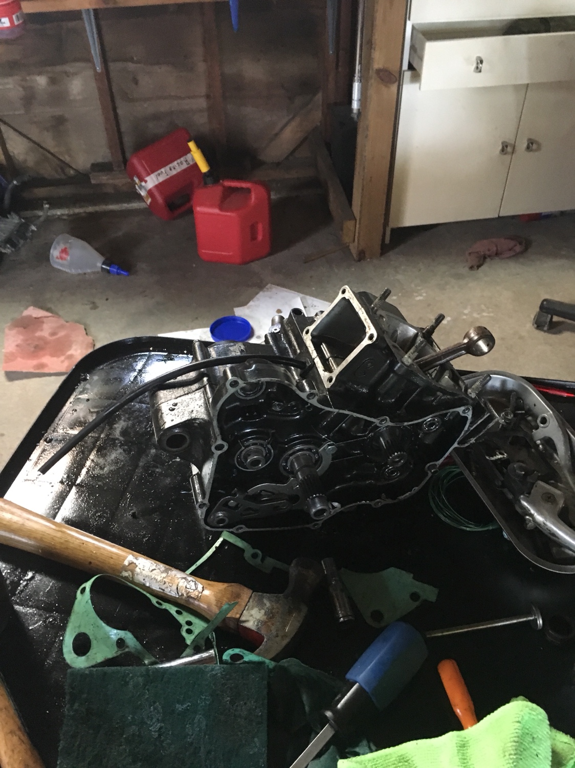

Bittersweet win today. Before you laugh, I’m trying to get my third mc permit. Finally, fixed my 1983 xl600r. Was having carb trouble so it kept getting put off. Well, I failed the written test. I didn’t know my jail times and drinking fun facts. Thanks DMV. Anyway, I got the cases back together and she shifts!!!
Don’t mind the messy crime scene area. Late night wrestling and such
