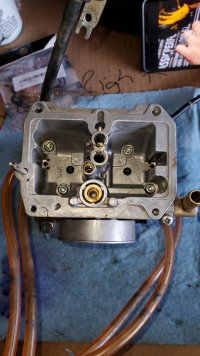

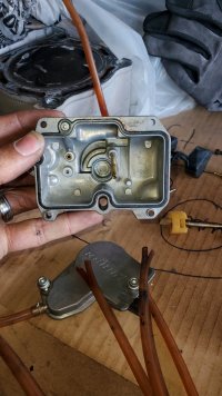

Ok, I know from jump something is wrong with carburetor. It leaks sometimes when Im trying to start bike but once bike is started, it doesnt leak.

Tough one here .. If carb leaks , float needs adjustment , or valve is not seating properly ... If too lean on pilot jet , it could be a problem .. what is pilot jet size ? Main jet ? Elevation ?

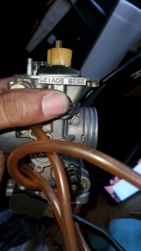

Sorry, but those are things I dont know just yet. All of this is a first for me so Im learning and retaining all the information as I go. Never had to deal with carb just yet so have no idea what sizes of what are.

Pull your plug to check if it's too lean or rich. BWM is right about the leaking carb is either a float level problem or leaky float valve. Has the bike set up for a while? Did you clean the carb?

No havent cleaned carb yet. I did purchase a rebuild kit for it, but was so excited after completing engine rebuild I just tossed carb back on.
Just trying to get possible issues for more experienced people, then I will look up how to check the things you guys suggest.

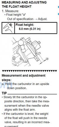

So when I get off work today will YT and google how to check float levle and float valve

I would start with the idle is too high, which is helping that pipe glow, almost immediately I bet.
The carburetor will have numbers on the jets, record them while you're in there cleaning.
The float has a spec most likely in the manual you can measure from carburetor body itself.

I will start with trying to tweak the idle today when Im off work since that seems like the simple task and within next few days get to taking carburetor off after I research bunch of videos and info, then next off day see whats up

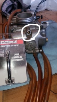

Carb didn't even look that bad but still rebuilt it and added an adjustable pilot screw.
All seems good. Was test riding and exhaust didnt get as red as yesterday mid day did, no carb leak. Started on first kick too.
Just want to thank everyone that chims in with help and direction. Months ago I didnt know shit(probably still dont) but I have now rebuilt my whole bottom and top end, carb as well physically by myself, and am now back to riding.
