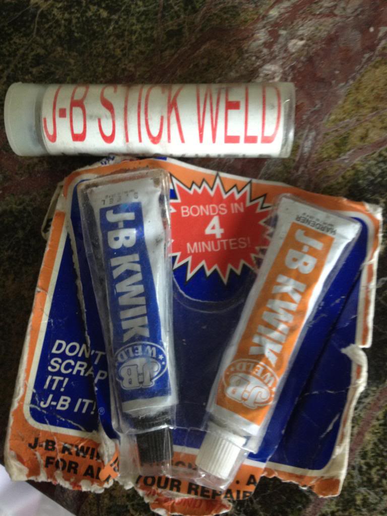

I dont know if you guys have it, but in Aus we have an epoxy called Quiksteel thats perfect for this sort of thing. you knead it together and apply it and after 15 minutes it sets as hard as steel. You can grind, shape and paint it.

I found this in the bottom of my trail pack. Would this work on it I wonder?:noidea:

Not sure if JB Weld is the same as Quiksteel but, if it is I think I will try it. Just not sure because it is titanium. Thanks for the info:thumb:
