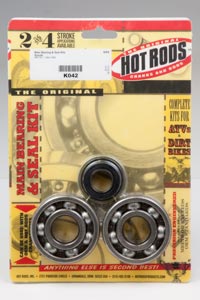

Main Bearing & Seal Kits
For Models: 1992 - 1998 Suzuki RM 125
View Details »
Part #: K042
Price: $59.95each
