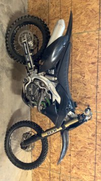

i have a 2011 450f i got it for christmas, it was a decent deal at $4k and we talked him down to $2.5k. he said he traded a built race quad, he said it was rebuilt and had a higher compression kit on it when he traded it. the bike came with KYB front suspension and i’m not sure about the back, a rekluss clutch kit, and levers. that’s all that i know is done to it. i have noticed the clutch acting a little funny when on the stand in gear, but i also have been riding for almost a year now and im not to experienced with the mechanical side all i can do is ride good lol. any tips on what to check and maintenance tips are super appreciated. thank you.

These need you to monitor valve clearance, otherwise, change the oil/filter and ride!

You might want to grease the swingarm bearings and linkage. These often get overlooked. Use some good waterproof grease like BelRay.
