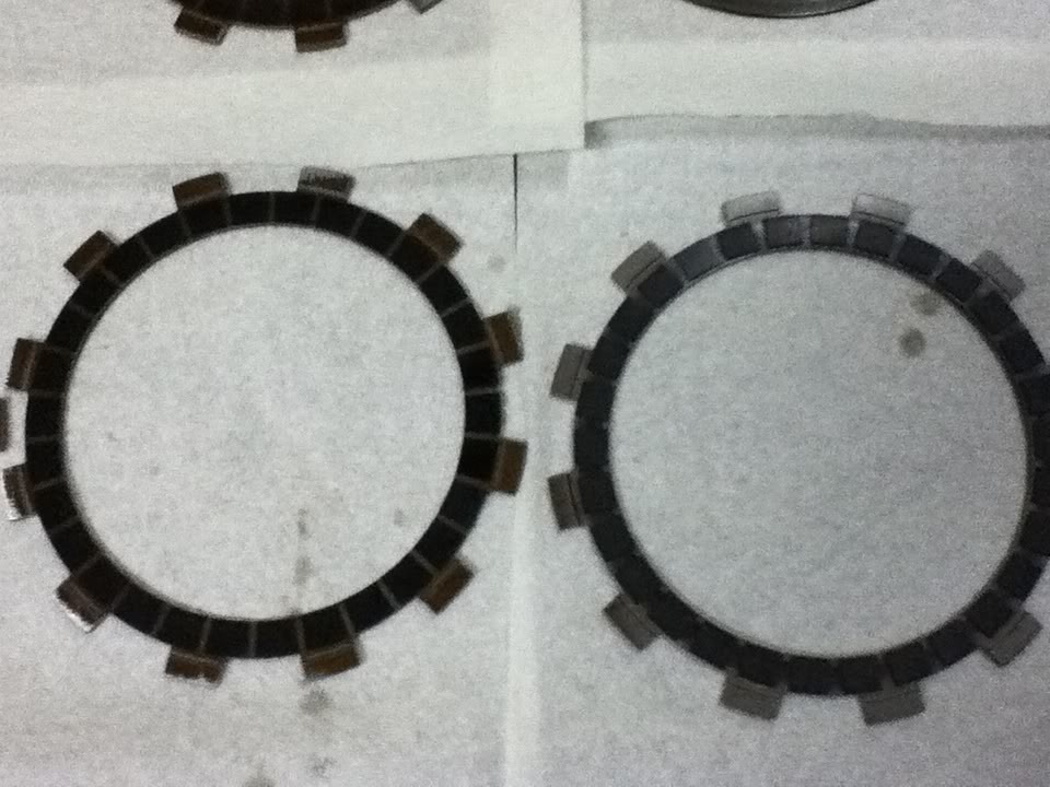

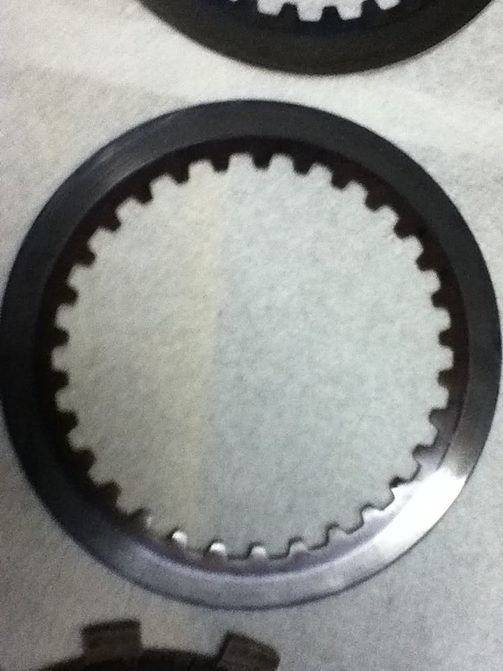

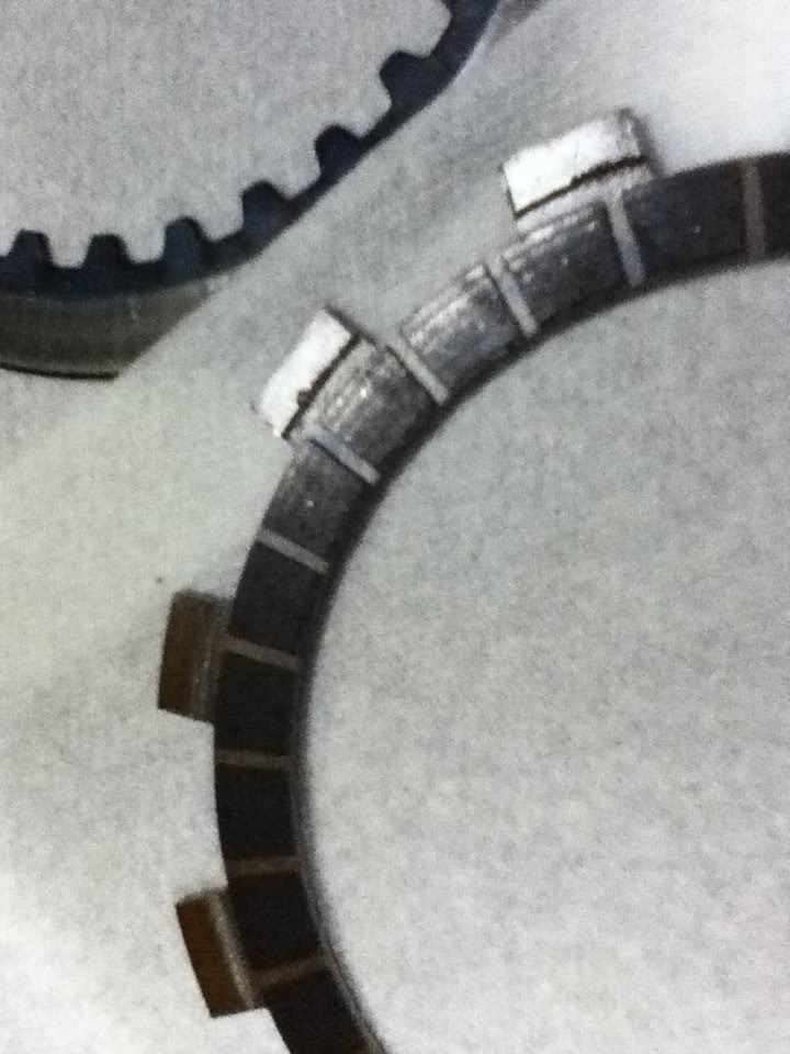

My 2007 YZ250F has been acting rather strange lately. It creeps forward in gear with the clutch pulled in and also doesnt want to shift sometimes, like the clutch doesnt want to disengage all the way or something. And yes, Ive made sure that the cable is properly adjusted, its not that. It is NOT slipping, but rather the opposite I guess. From what I've heard, that is usually caused by a notched out basket. However, I just took the clutch all apart (keep in mind the previous owner replaced the entire clutch assembly with a Hinson one, so nothing Im talking about is stock) and the basket is surprisingly immaculate. Not even the slightest mark can be found on the basket teeth...things, if you get what i mean. The Inner hub has very VERY slight notches in it, practically unnoticeable unless you look really closely. Youd almost need a magnifying glass. From what Ive learned something so faint could not be causing an issue. The pressure plate is also basically perfect. When it came to looking at the plates, however, they were not as perfect (I think). All the steel plates are blue and tan in some spots. On the frictions I noticed deep and ragged grooves on the edges of a couple of them, while others had none. Some of the plates seemed dryer than others. Also, the springs were surpisingly pink on one side of all of them. What does this mean? Do they get that color when they go bad, or did hinson just paint them like that? Hopefully you guys will be able to give me a better idea on this. Remember, i dont want to replace this stuff if i dont have to, but I also want to be able to shift. Here are the photos. Could they be causing my not-being-able-to-shift and creeping forward issue? Thanks.
The steels dont look good at all, they may be warped....if your steels look like that then maybe your basket and hub are notched...how do they look?

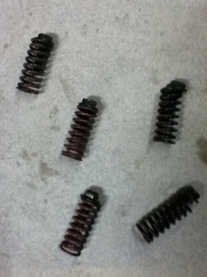

EDIT: Springs in forks, shocks, and clutches are painted to designate compression values. (I.E. harder, softer, faster, slower)

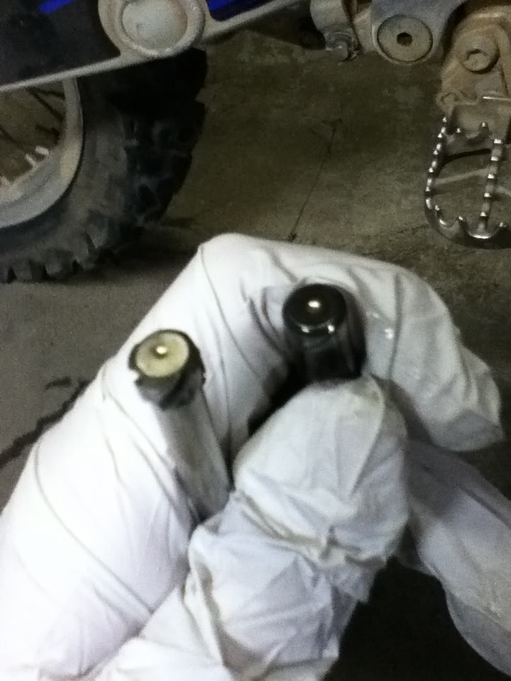

1. forgot to mention that oem clutch perch is also brand new. I checked it and everything is on there correctly.
2. did that and found nothing unusual.
3. Ball bearing is not there, and I can see a tiny tiny imprint for it about 1mm wide on the parts 18 and 23 from the diagram...dont know the names. remember its not the oem assembly, its hinson so the ball is apparently much much smaller compared to the diagram...unless theyre all that small. and also is part 23 supposed to freely pull out of the hole? because it did. and if i dont have the ball bearing can i still ride? it may take a while for that thing to get here.
SRAD97750
Moderator
Oh snap! No ball bearing!!! YOU MUST have a ball bearing, otherwise those two parts just grind on each other. Hopefully that's not why the imprint is so small! :shocked:
Without a ball bearing in the pushrod mechanism, you can't adjust the clutch properly.
Order that bad boy! Let us know how it goes.
The ball bearing allows the pressure plate and (18) pushrod to spin with the engine, while the long push rod remains stationary.
It's totally cool for the rod to pull out freely, it is just an idle pushrod that transfers cable motion to the pressure plate. Take some photos! -BIG DAN

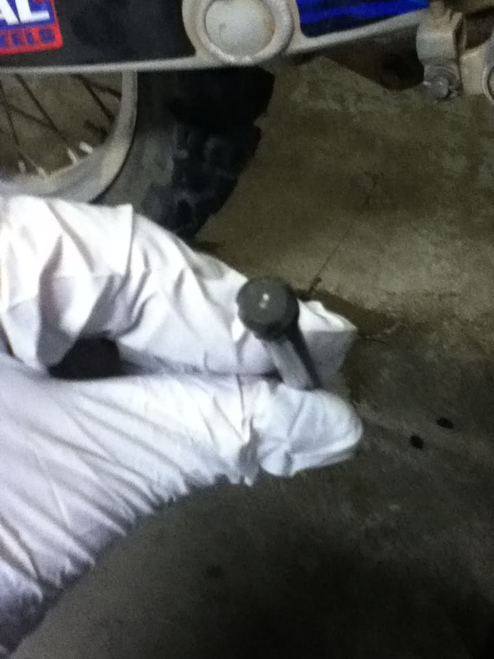

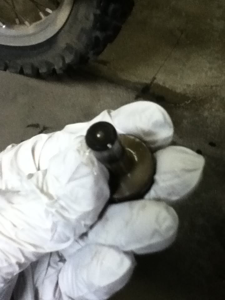

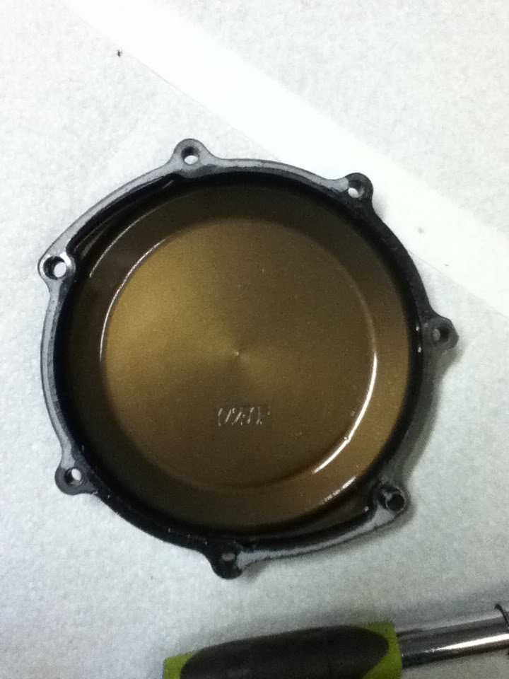

These are the pics. Is it supposed to look like this? Look closely and you cann see the tiny imprint for the bearing. Also, isnt the clutch cover supposed to have a seal or gasket or something? Mine has nothing, not on the cover or on the case. Nothing has ever leaked out before though. There a strange white paint on the outlining of the cover, as you can see.
SRAD97750
Moderator
yes sir! You are missing the ball bearing. I suspect it crushed down and disappeared into your crankcase. Out with the oil!
Order the bearing! You are almost ready to ride!!!
The white "paint" is most likely what's left of the old gasket, or they used gasket maker. (rtv)

I hope this is whats causing the problem. Are these parts worn down at all, and is that why the little holes are so small or are they supposed to be like that? And thank you for replying so early, its 5:30 am and I was just about to start my rebuild. Also, would it be ok to ride like this without the bearing for an upcoming race this sunday? I cant afford to miss it and that part will probably get here afterwards.
