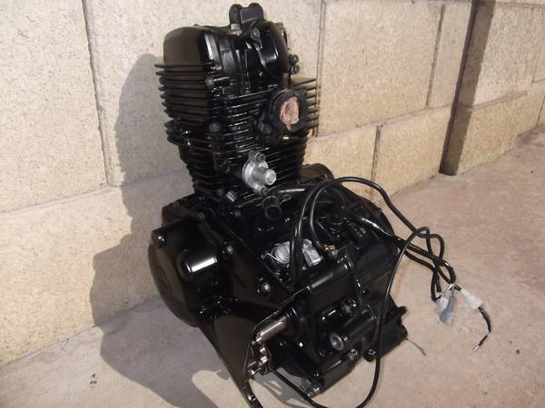

Why not buy a whole bike with the 225 6 speed and an electric start? Then put it into a 250 frame from the early 90's as it is an easier fit.
The idea was to cobble something cool and unusual together with what is on-hand and available, but I do like the electric start idea.
you have the 400 dollar freshly painted 200 hundred on hand? I wasn't aware of that. Is this something you have to get done fast so that you can ride it to work, go to the hospital, or evacuate the area due to fire, bombs, terrorist attack(s)?
