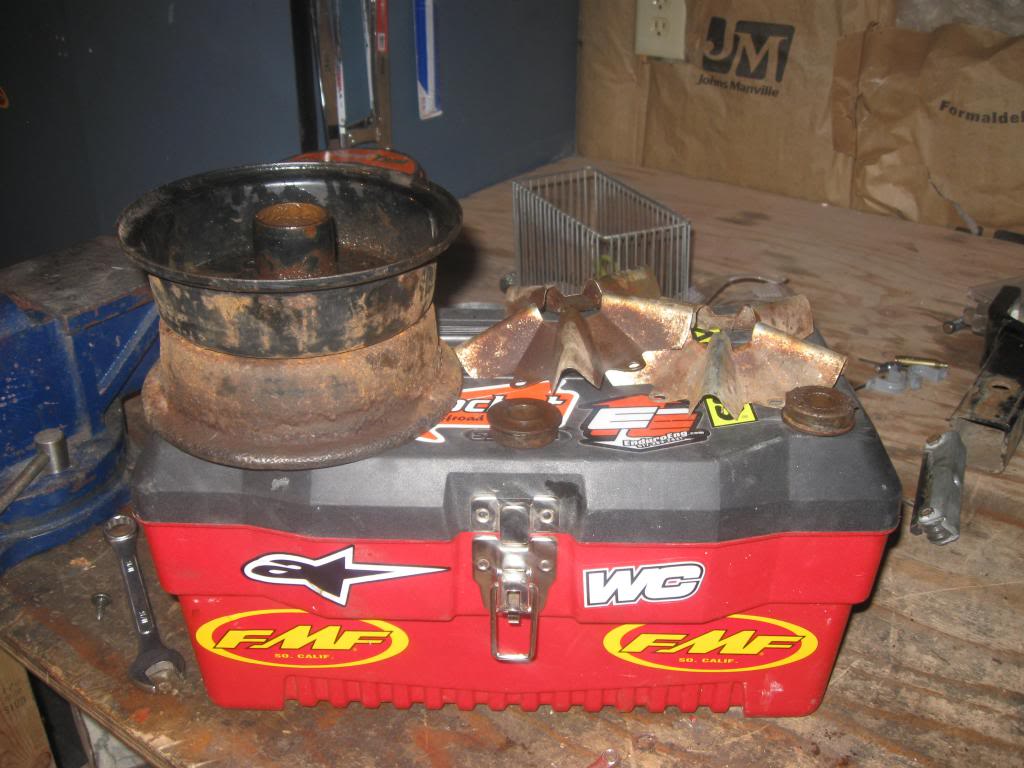

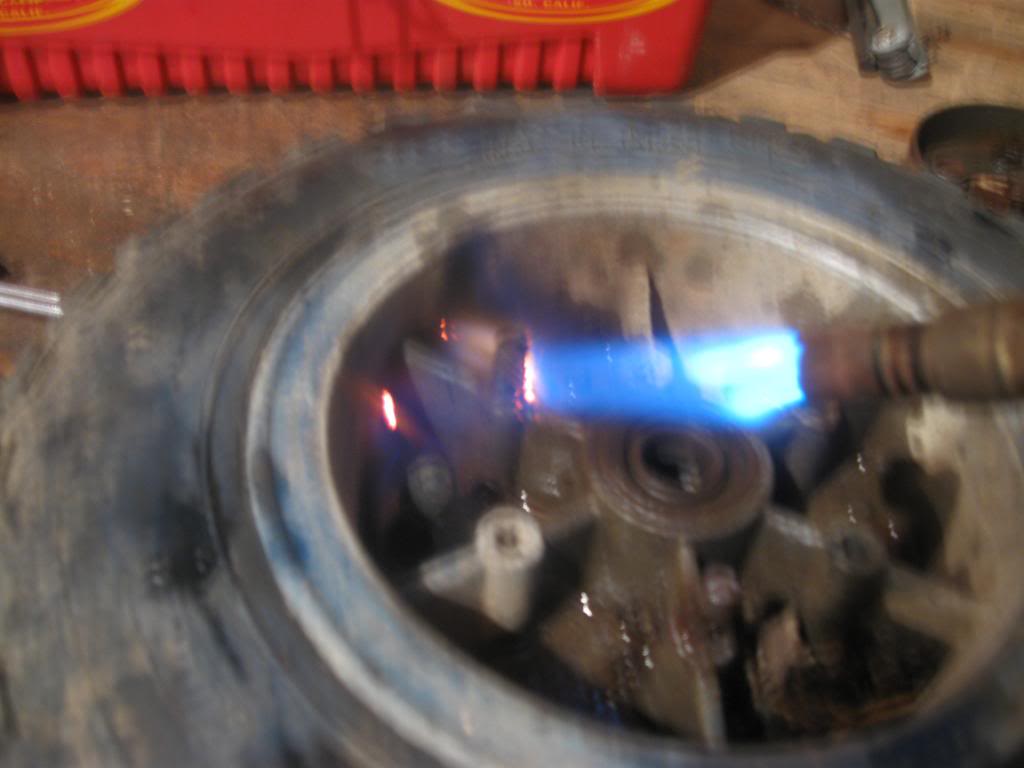

I removed the tires. The front rim is in good shape and should be restored easily. The rear rim however didn't fair too well. It has some damage and may need to be replaced. I will try to find a new one, but if not I will have to get a whole different kind of rim.
The color scheme im going for is going to be like my 450. The rim will be blue, the decorative center pieces will be green. The bearings definitely need to be replaced, they were tough to get out even with my bearing remover.

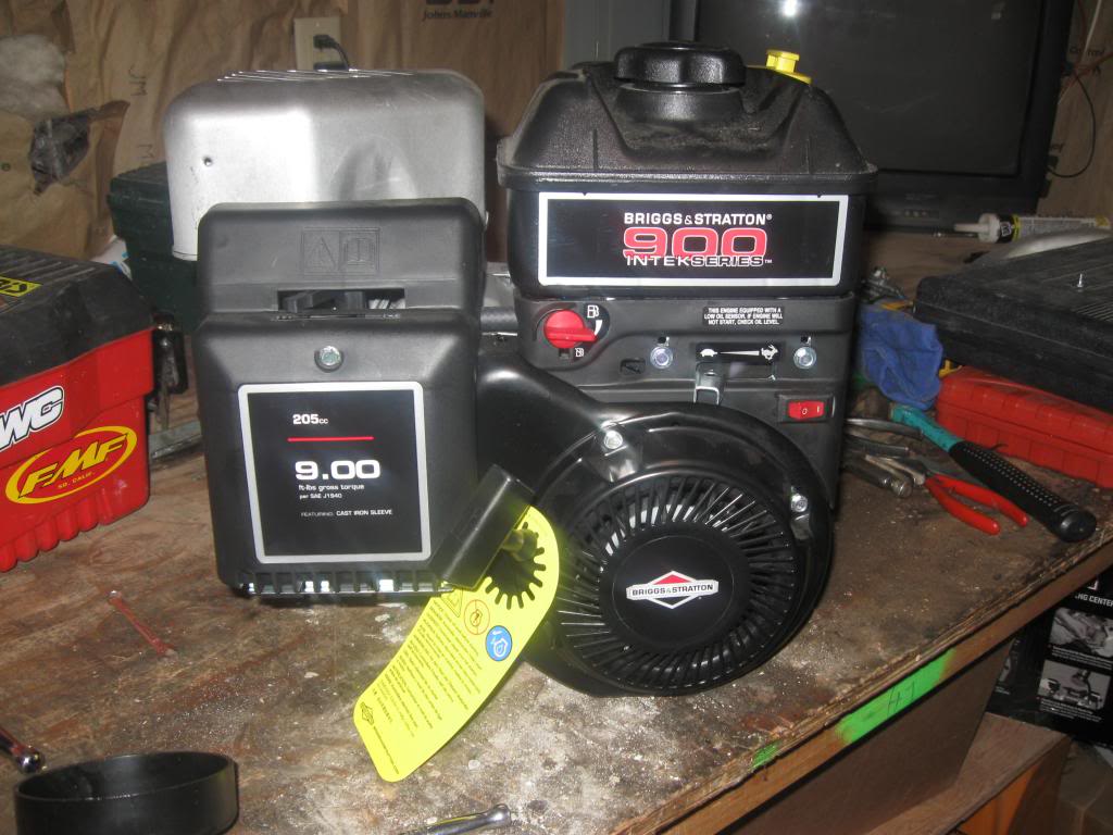

A Briggs and Stratton 900 series engine. It has 9 ft lbs of torque at 2600 RPM and 9 HP at 3600. I was going to get the 1000 series which is a 10 HP, but 10 on up has 1 inch shafts, the clutch im using is a 3/4". This little guy is going to be perfect for this mini bike. It was $238.50 at a little shop, all the big name hardware stores had it for $360+! I also bought the chain and the sand to sand blast the frame.

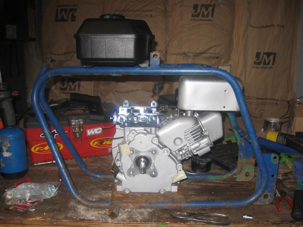

Here it is mocked up in the frame to make sure it fitted. I like how the exhaust is going to go under the seat and out the back. The only fitment issue was the oil fill spout, it was too tall and hit the frame. A couple of oil plugs fixed that right up.

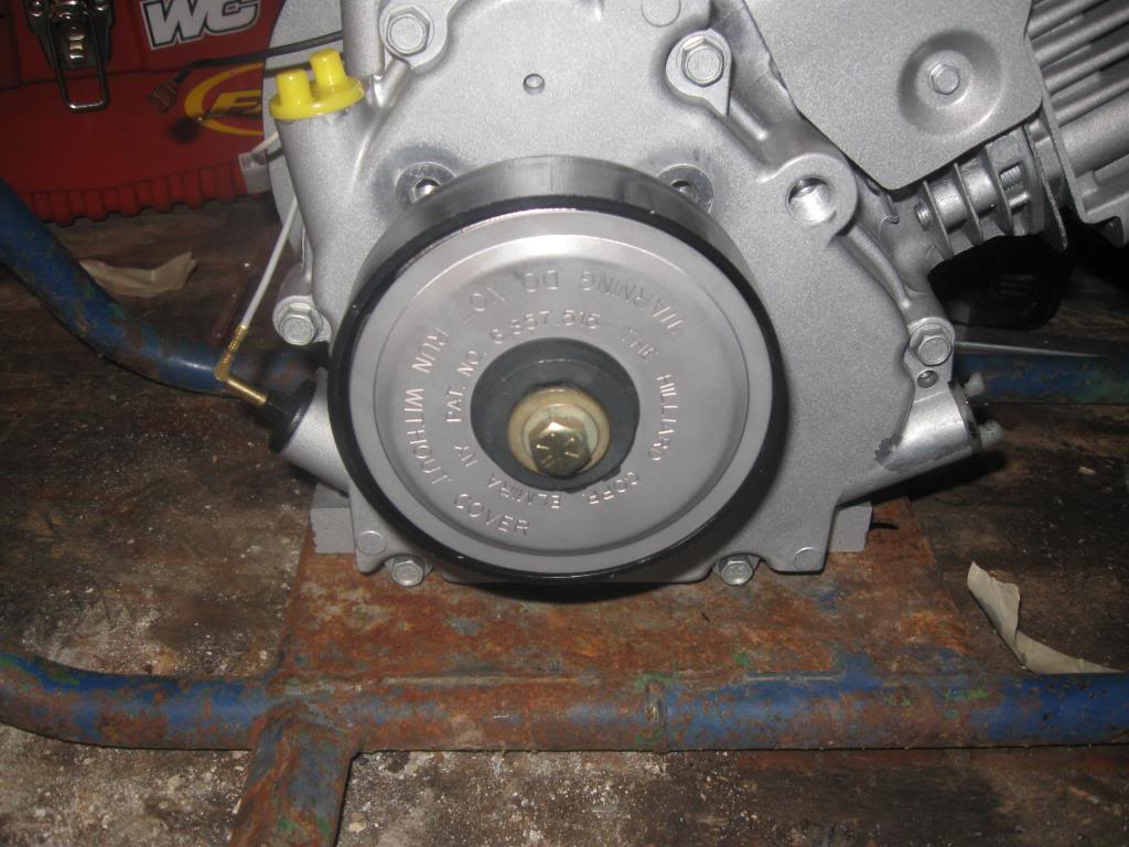

here is the centrifugal clutch added to it.

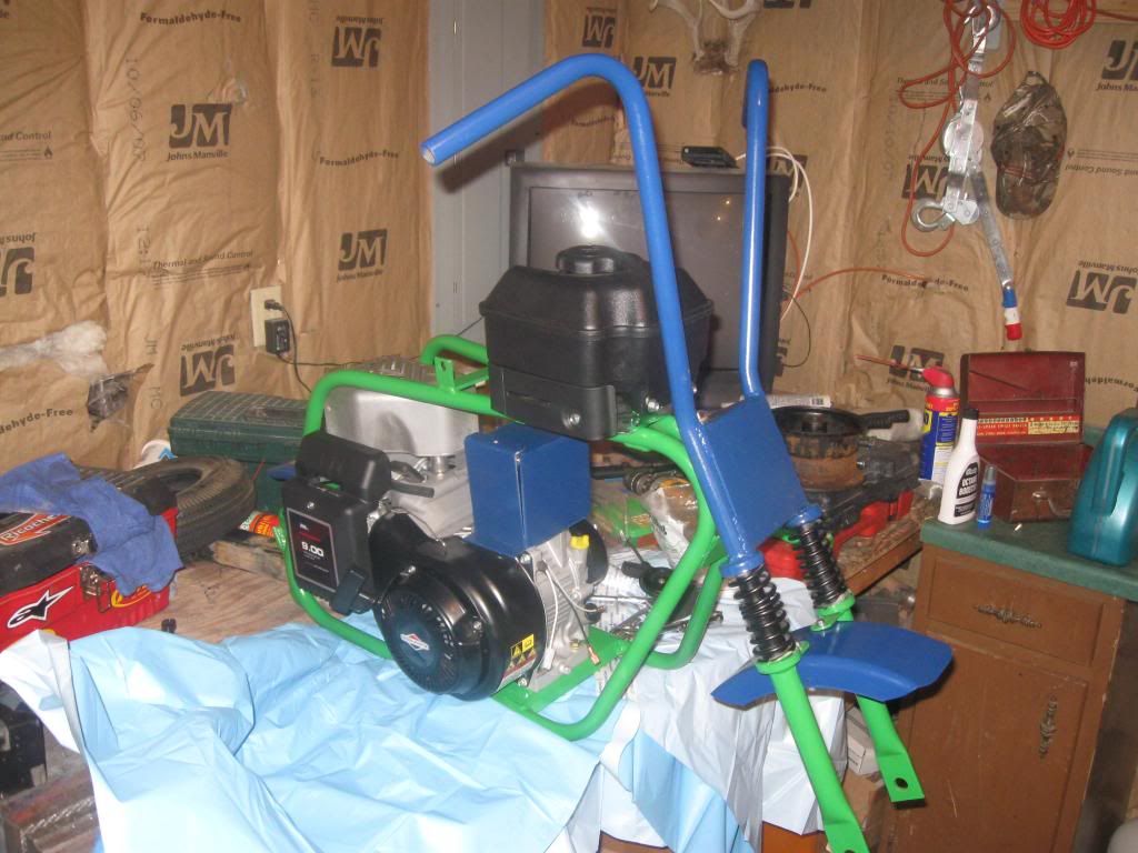

Sand blasting the frame tomorrow morning. Im going to paint it as well. I ordered all the stuff needed for it so when that gets here I can have it together and running. Shouldn't be more than 1 1/2 weeks (allowing for process and shipping times) before this old mini bike is back together and running strong.
