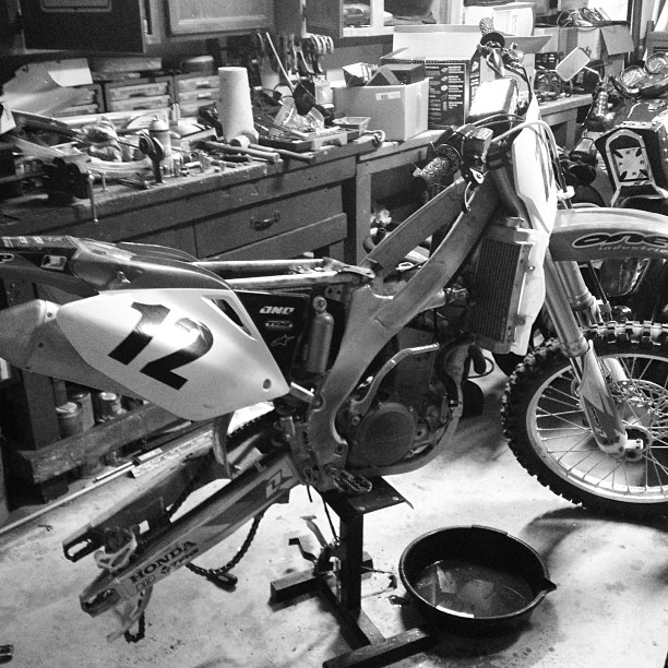

As most of you know i seized my neighbors bike which i borrowed. Yesterday i started to tear down the bike to figure out what happened and broke. This will be the rebuild threat and will post pictures up keeping you all updated on the build.

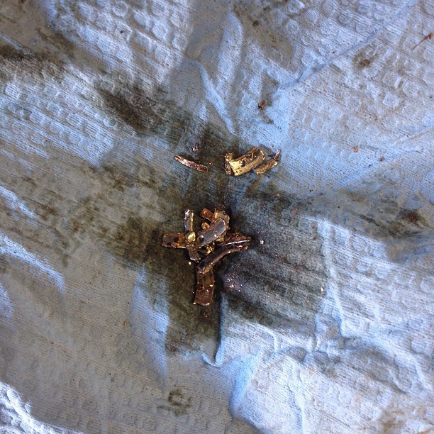

Got the engine out last night. Drained the oil(s) and coolant. oil seems pretty clean, however when i took out the oil filter there was a ton of medal shavings on the filter, looked to be aluminum not steel, so piston or bearing? I will get more pictures later today when i open the engine up a bit more.

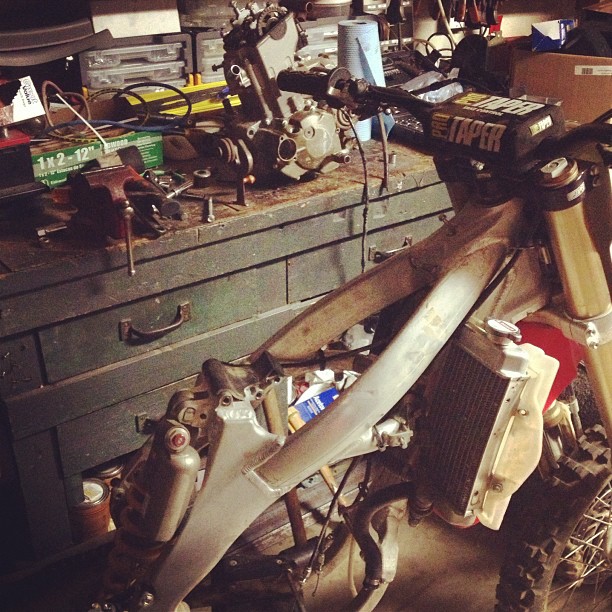

I was able to get the top end removed today and get an idea of what the damage is.
I found some more chunks of medal looking like rings, or possible bearings.
After removing the head completely i saw where the medal pieces seem to be coming from, From the top view it looks like the crank rod bearing is the little faggot who decided to take a shit.
